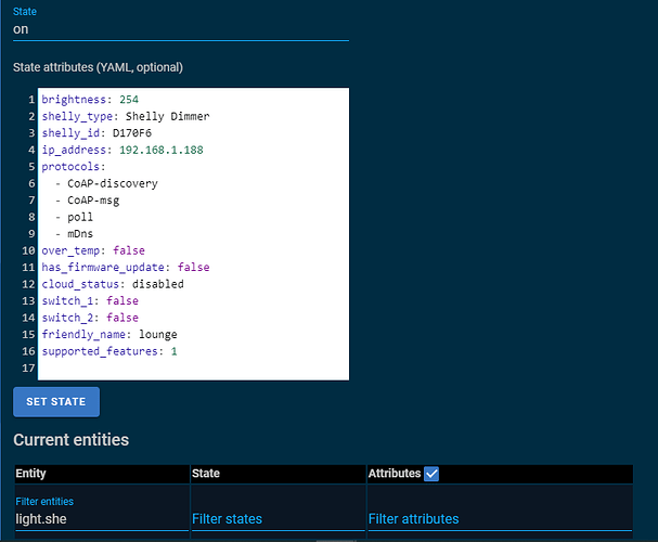

well bro you need some template training
I have
I want to read the IPaddress ( could be anything)
let go to the state page and find it
now I Know that
open new TAB goto the Template Page and lets start playing
{{ states.light.shelly_lounge.attributes.ip_address}}
ok cool we can pull stuff out of the "attributes"
now this where the rules change on what manual user you lession to
me I like to make a sensor template
so what working in templates
  - platform: template
    sensors:
      lounge_ip:
        value_template: >-
          "{{ states.light.shelly_lounge.attributes.ip_address}}"
do the config check and restart pray
it work I have a sensor
