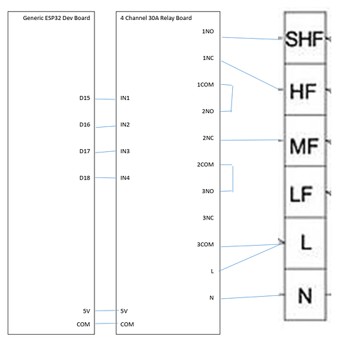

Hello, I need help with designing esp based fan controller for FCU.
- Fan
— On / Off
— Speed - Slow, Medium, High
If you are ready to help for a reward, pm me for the details.

If I were doing this, I’d get one of these 4 channel SPDT 30A relay boards and wire it such that L could only be connected to one of the FCU terminals regardless of relay position. Relay3 would be used for ON/OFF. When Relay3 is energized it would power Relay2 common. Relay2 would power either MF or Relay1 common. Relay1 would power either SHF or HF. Relay4 is unused. ESP32 dev board powered from relay board 5V output.
@mulcmu Thanks for the board design idea!

You have to make sure you only put power onto 1 speed at a time as per your wiring diagram above. See in the link above and use the “interlock” to ensure this happens or you will let the smoke out.
The fan motors have 4 speeds

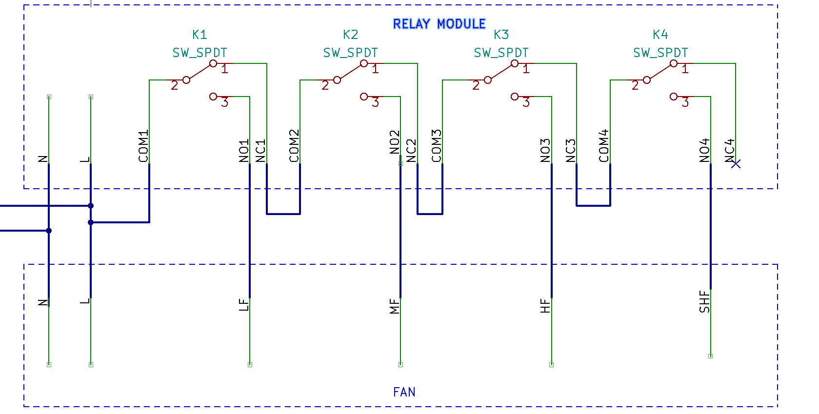

The schematic I posted above had the relays wired differently than the linked post. The linked post is a bit more intuitive as one and only one relay is energized for each fan speed. To wire the 4th relay to LF this would be the arrangement:

Same relay board should work, was the motor HP and current within the relay rating?
When none of the relays are energized the incoming line power ends up on the 4th relay normally closed contact which isn’t connected to the motor providing the off state.
Nice work on the code changes for 4 speeds, it looks good to me. Is there a d1_mini board with ESP32 processor? Check that configuration. I’d also put the interlock_wait_time of 200ms back in like the go-by code used.

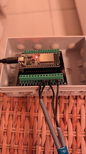

@mulcmu I am planning to use this board as you suggested in the first post.

@mulcmu
I have connected the board and relay but it doesn’t seem to be working.
When the relay switches, should I be able to hear a clicking sound?
Are there any mistakes that could be causing this issue?
I am using the following config:
esphome:
esp32:
board: esp32dev
framework:
type: arduino

Some (many) of those relay boards require you to pull to ground to activate the relay. Check the specs and then set the GPIO to be inverted …
pin:
number: 18
inverted: true
mode:
output: true
@k8n Thanks for the suggestion, but it’s still not working. After some research, I have found a review that stated, “Arduino did not have enough current on an output pin to trigger the board.” Do you have any other ideas on how to make it work?
As I understand it, there are multiple options to make this work:
Has anyone else had similar issues where there isn’t enough power output to trigger a relay?
