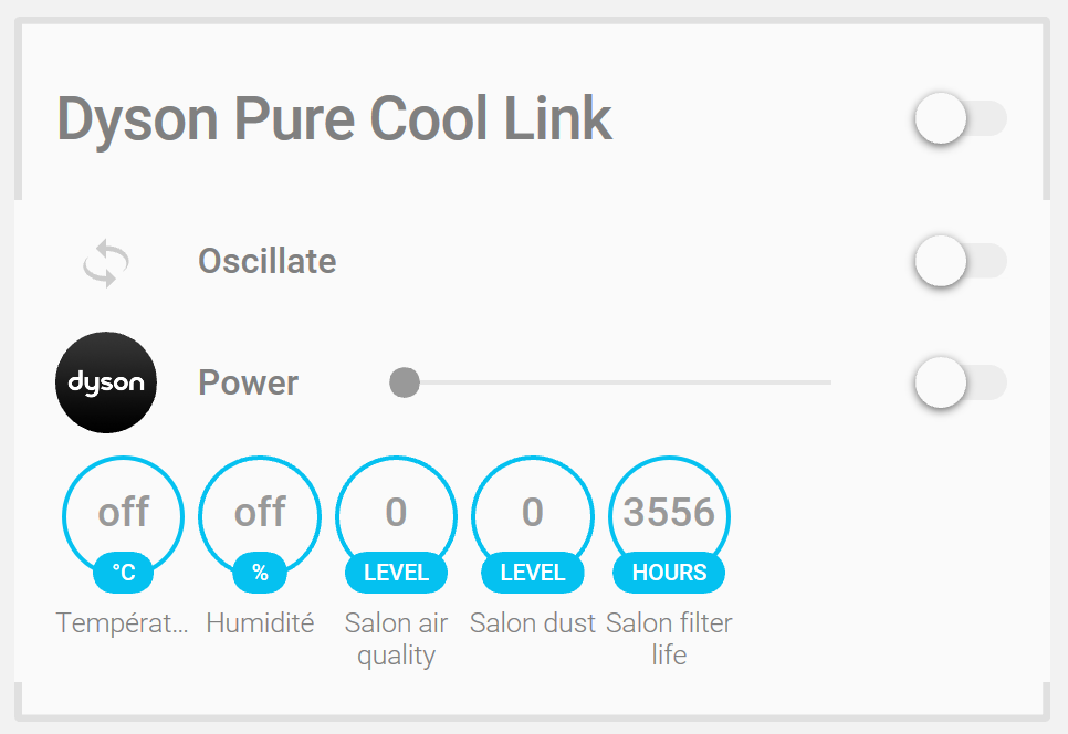

I would like to know if it’s possible to make this slider from custom UI control the fan speed.
I have a dyson fan with 10 speed, i used the “custom_ui_state_card” to add the slider with the 10 positions.
It would be awsome to be able to make it work somehow.
Here is the code i used in customize_glob:

Off the top of my head I would think no, because the slider in custom_ui is not a universal slider, but a ‘brightness’ slider, so probably specifically links to the light/brightness service.
Unless someone can tell you how to link it to your fan speed, then you’re going to need an input_number on the line below I think.
(totally happy to be wrong on this btw, and hope someone can help you get it working as desired)

I have finally make my button “oscillate” working fine for the dyson link fan.
I used the input_boolean to achiver this and it was quit difficult for me to understand the process. I want to share my code for the peeople interested:

could you show your configuration of card? looks cool, but don’t understand how to access pm2.5 or Noc level from dyson.
This card won’t work anymore with lovelace. Sorry.
