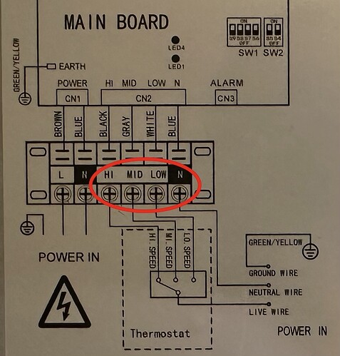

Hello everybody, I’m setting up the climate control in my house for the first time in Home Assistant.
I have a fancoil which speed gets set through 3 contacts, one for every speed. So to set the speed to low you have to close the first contact, medium is the second one and high is the third one. If no contact is closed, the fan stays off.
I’m going to do this through three relays, one for every contact, connected to an ESP32 S3 board.
I’m trying to setup a card in my Home Assistant homepage that shows three buttons for the three speeds, and there can’t obviously be two buttons pressed at once, it has always to be just one button pressed or no one at all. So, my idea is that when you press a button, the other one
pressed deactivates.
Being pretty ignorant in programming, I have no cloue about how to do this. Does anybody have any idea, or are there any old topics about this? Thanks in advance to everybody!
I’ll leave a picture just for more clarity:

By the way, I think I found a solution: looking on the ESPHome page for the GPIO switch I learned about this configuration variable called interlocking. With interlocking you can prevent two GPIO switches from being active at the same time. So this means that when I activate one of the three switches for the fan speed, the other one active gets deactivated. I even tried it with some spare relays I had and it seemed to be working really good.
