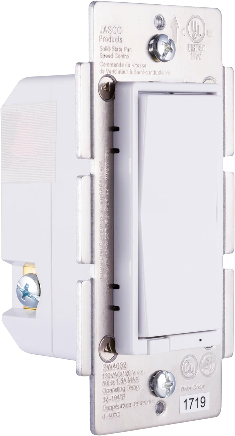

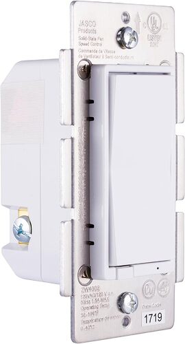

I have the GE branded version of these for five fans that have been installed for several years without any issues. They’ll only control the fan on/off and speed. They’ll only be able to control the speed of AC powered fans (sounds like that’s what you have). Since you have a second switch for the light, you’d need a separate light switch for it.
