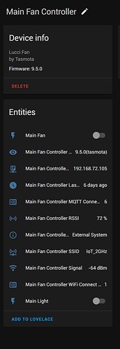

@septillion and @koying thanks for the help.
Okay so to clarify in my head mainly, the template I have is simply buttons and stuff, there is no actual “meat”. My fan is configured through the Tasmota integration, like this:
So how do I connect my fan to the template?
Thanks

Basically, replace your empty scripts by service calls on your tasmota entities.
Something like
turn_on:
service: switch.turn_on
target: switch.main_fan
turn_off:
service: switch.turn_off
You’ll have to figure what service to call for each functionality.
So you’re only able to turn on and off the fan and light?
If so, what is the benefit of making a template fan?

But can you control the speed with the “Main Fan Controller”-device you have in HA now? If not, making a template fan will not help.
