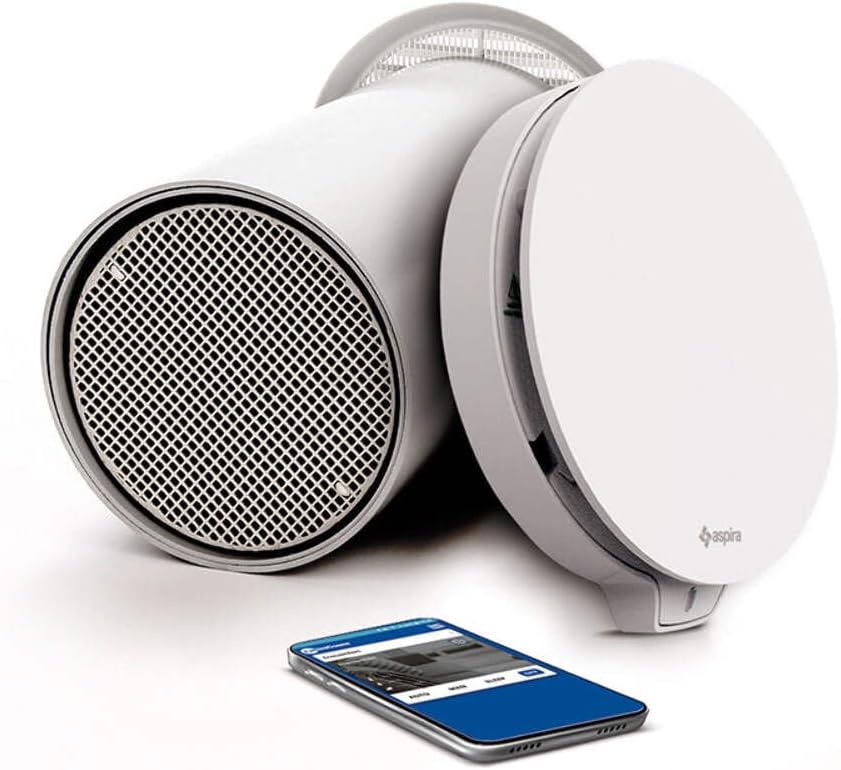

Hey there! I am thinking of buying a couple of these - is the integration working, and is there a guide on how to set it up?
Thank you so very much!
PS. 1: Or if it’s expected to be released… So I can know, if I should jump the trigger and order 4 pieces of these :smile:
PS. 2: That’s the product, right?
Hey George! It’s not yet released and is currently being reviewed by the Home Assistant devs as we speak. I had to reduce the initial release to only include the ā€˜fan’ mode and not yet the sensors (air quality, humidity, temperature) and will make another PR for the sensors once the initial release gets merged. The home assistant devs found the initial release too big to review, which is why the initial one only includes setting the fan mode & speed.
I.e., in the first release you can make time-based fan mode/speed automations, but not yet any sensor-based automations.
I don’t have a timeline for you, but I’m guessing ā€˜soon’ for the first release. The one after that with sensor integration could take a while, seeing as how long this one took. Totally depends on when the HA devs have time to look at it :slight_smile:
Once released, there will be a documentation page on the official home assistant integration page which includes how to set it up, which should be pretty straightforward. And yes, the units you linked are the ones I have and have integrated in this integration.
