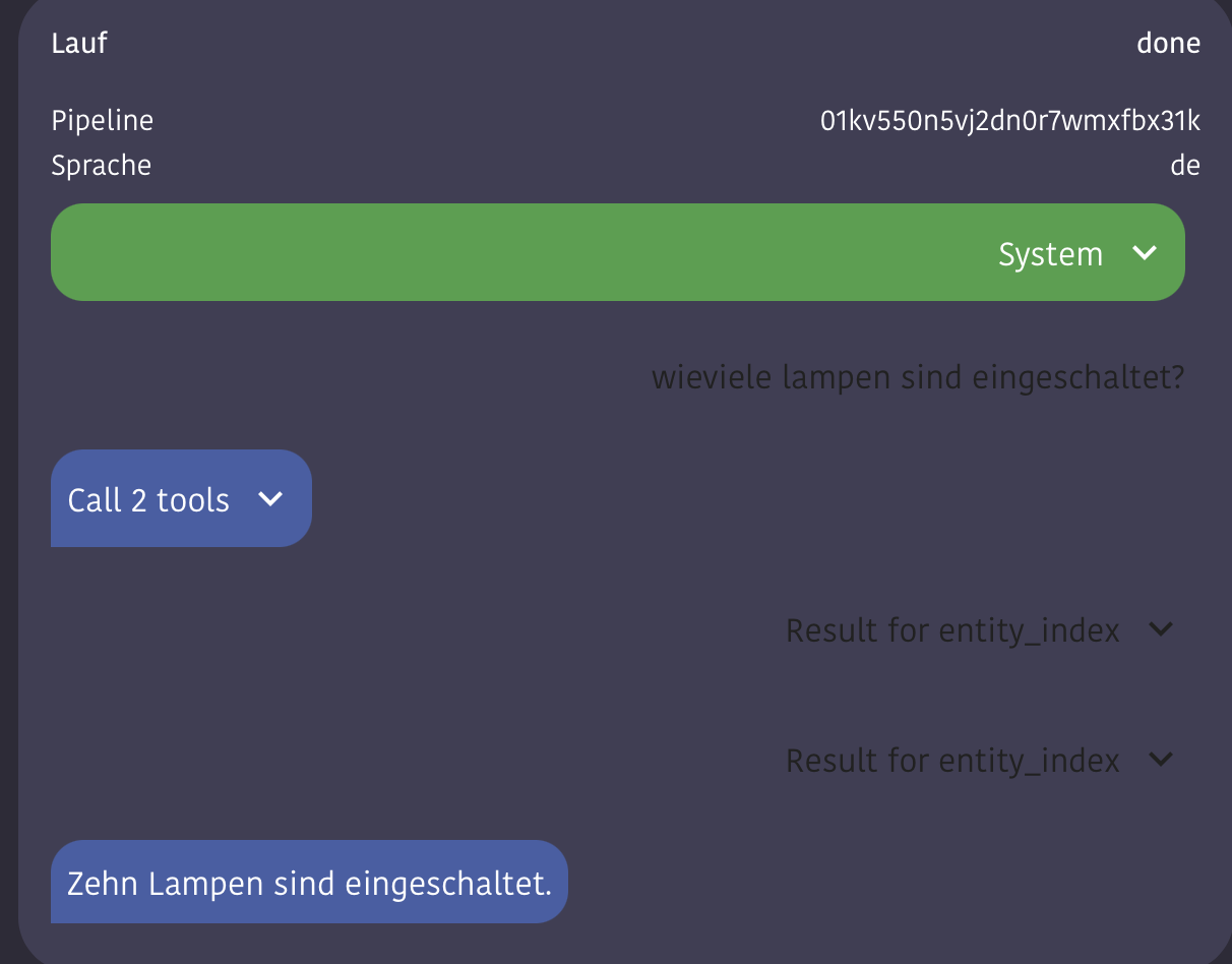

@kiwipaulrob do you also see the model calling every tool twice in the assist debug view?
It happens for every tool that the LLM calls for me.
Crazy that it's still so fast. :face_with_tongue:
