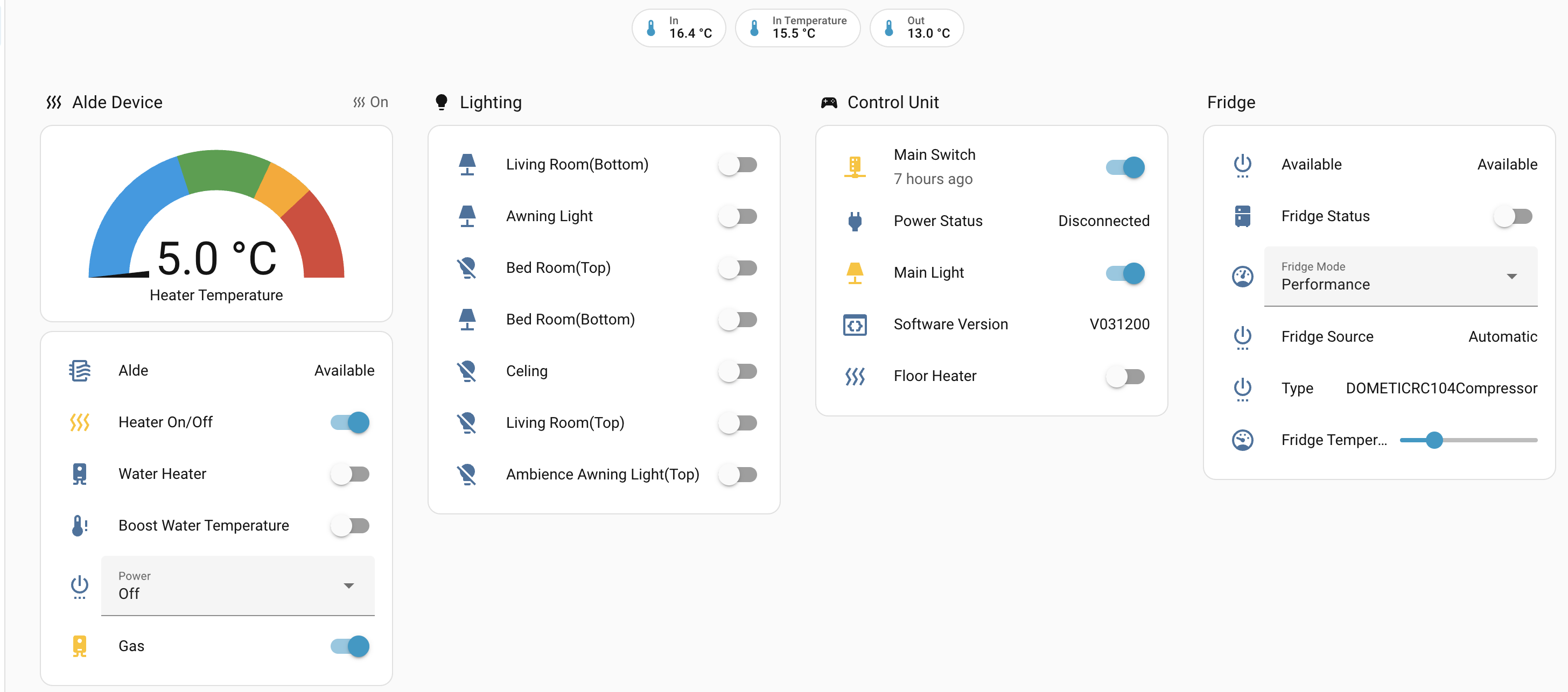

I was able to communicate with the Fendt Caravan via Bluetooth using an ESP32 C3. I started developing an ESPHome component. I have completed the implementation of the Main Control Unit and Alde devices of the Caravan. I believe Hobby Caravan is also using the same interface. After finishing the Fendt implementation. I can start the Hobby Caravan. But I need your help for testing.

Sorry for the late reply. I missed this conversation. I have completed ESPHome device development for the Fendt Caravan. Is there any procedure to send PR to the main ESPHome dev branch? If you guide me, I can send a PR to merge my development into the dev branch.

I have pushed new PR. You can reach codes from following branch, Currently, my code does not support Truma Combi/Heater, If some body help me for testing. I can also add this feature. There are some missing implementations like Water Level, Battery Level. If needed I can add this functionalities.

Current PR contains onlu Main Control Unit device sensors. When the PR merged. I will add other device sensor developments. After everything completed, I can start development of the Truma Heater. I will keep posted here about the progress.
