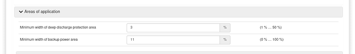

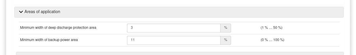

Great job! For changing the value BatUsDm.BckDmMin
it’s possible through the set parameter ? I can’t figure out which entity I need to choose.

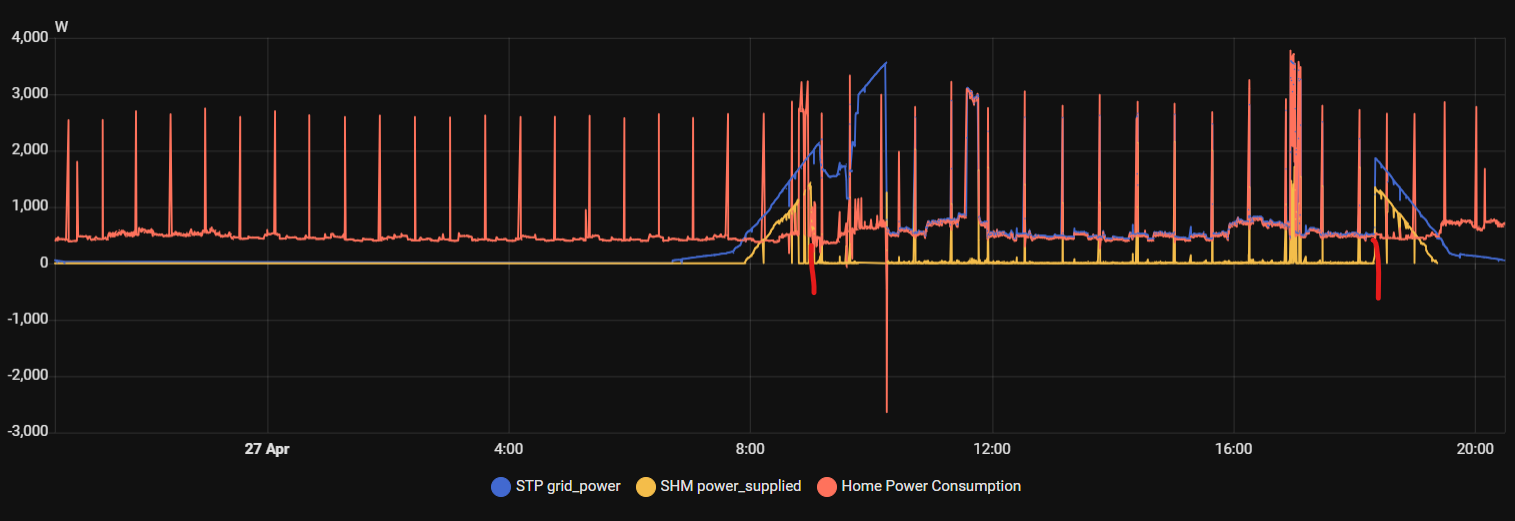

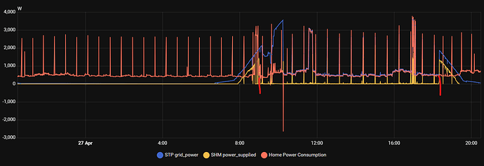

Furthermore, as I have a setup with a Sunny Home Manager 2.0 and a Sunny Triower 6.0, I did not change the Inverter “Active power limit” with the key “6802_00832B00”, but instead the “Set active power limit at grid connection point” with key “6800_0092D700”. Note to also set the following: “Operating mode of act. power limit. at grid connection pt” to “Fixed specification in Watt”, with the key “6800_0892D600”.
This will then nicely limit the grid return to be “0” while the inverter modulates to the consumed power, e.g. run at max while the car is charging with solar power and a negative electricity price :sunglasses:.
The graph below shows the effect of limiting the power at the grip point to “0” [W] (between the red times): the inverter modulates the power (blue line) to match the house consumption (red line). The power supplied to the grid (yellow line) stays at zero for most of the time, only some small transients due to the cooker boiler heater spikes. (Missmatch at the start is due the the heatpump consumption not shown…)
I’m monitoring the behavior of “Operating mode of act. power limit. at grid connection pt” as it did reset to “off” somehow (maybe due to the sunny home manager web-interface override?
