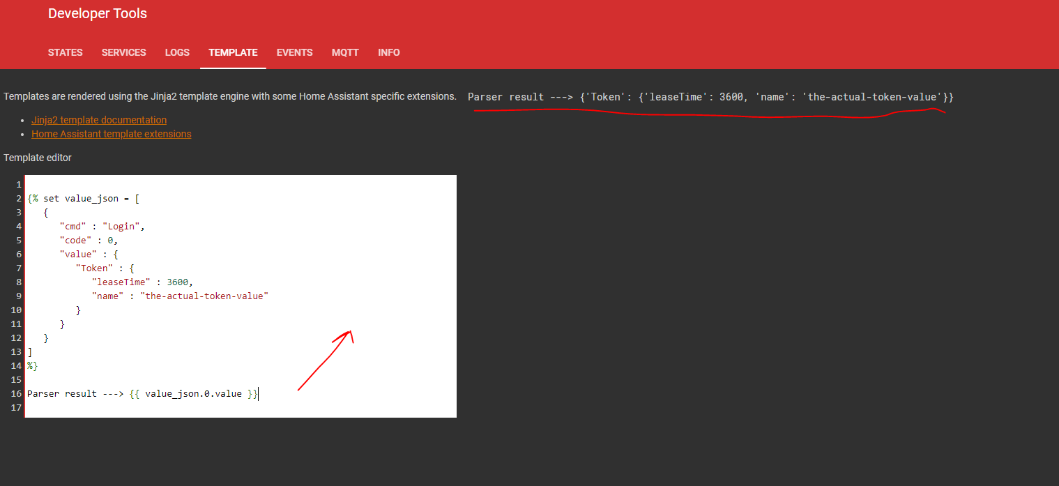

value_template: '{{ value_json.0.value }}'
json_attributes:
- value.Token.lease_time
- value.Token.name
And that’s all for now. The rest sensor has been failing but I don’t know why because I don’t know what is the exact request it is doing. Is there any log where I can see the actual request? If I try a curl request with this same values I get a satisfactory response, which looks like this:
"cmd" : "Login",
"code" : 0,
"value" : {
"Token" : {
"leaseTime" : 3600,
"name" : "the-actual-token-value"
Do you know of any other better approach?
