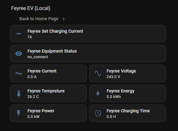

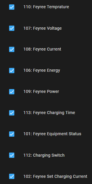

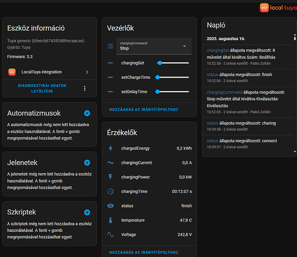

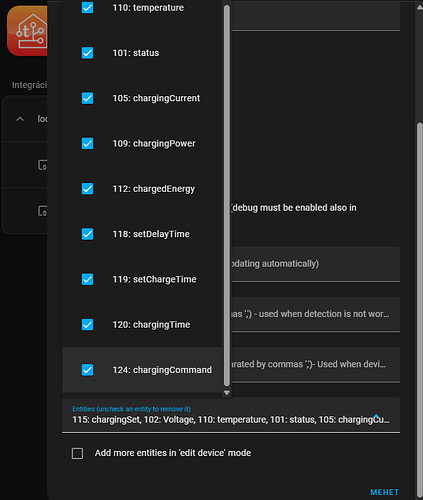

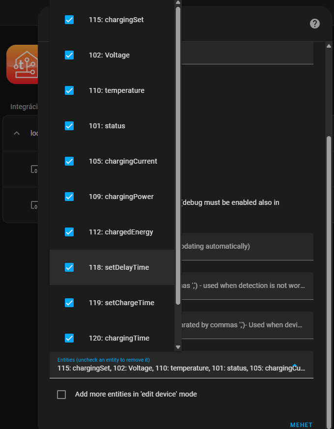

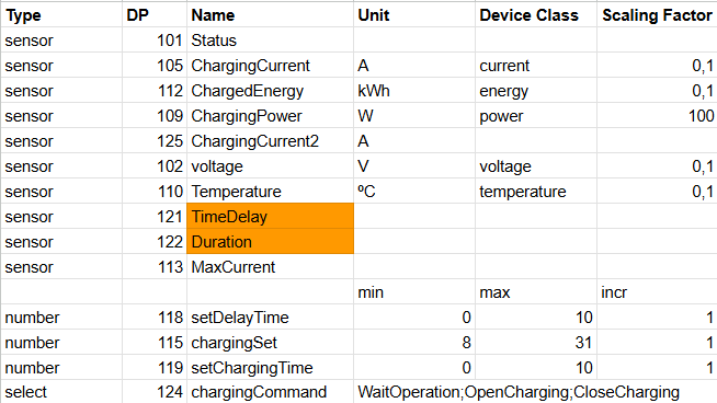

Update: I get it to work with the make-all/Local Tuya HACS integration. Discovered at the first try with the goodcell_ev_charger profile. Can start/stop charging and adjust the Ampere, thats all i need.
Hi ,
I have Feyree 1ph 32A Portable and i make work via LocalTuya .
here list of DPS
“dps_strings”: [
“10 (value: 0)”,
“101 (value: connect)”,
“102 (value: 10)”,
“103 (value: True)”,
“104 (value: 0)”,
“106 (value: 0)”,
“107 (value: 247)”,
“108 (value: 0)”,
“109 (value: 0)”,
“110 (value: 400)”,
“111 (value: 8)”,
“112 (value: False)”,
“113 (value: 0)”,
“114 (value: 0)”
I hope this is helpful

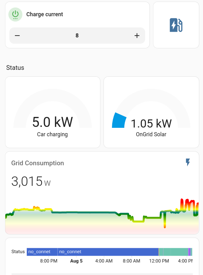

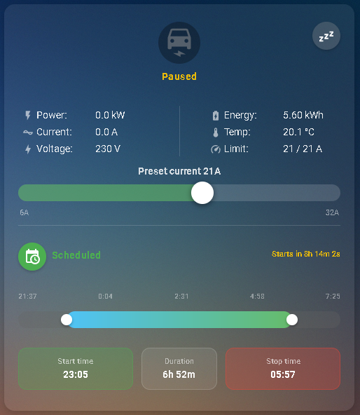

And most of them work as expected and I made a little dashboard like this:
But I have two problems:

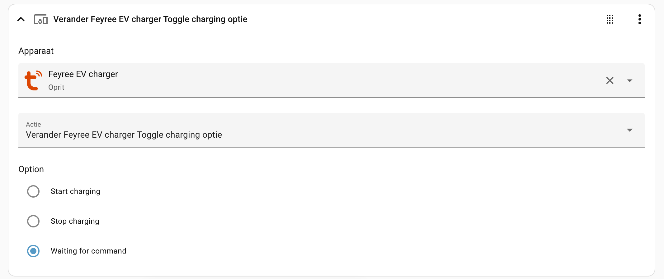

  1. I can only go down to 8A and this is not great. I am using DPS 114 for setting the current. I have the 16A 3 phase charger with the larger LCD.
  2. I can’t start/stop the charging process as I want. Charging starts as soon as I plug in the car and I can’t stop it using DPS 124. I can stop it with the Tuya app but after I stop it it doesn’t want to start again. Is this specific to my car? I have an Audi e-tron.
Hi, here is my solution.
I use the Feyree by the make-all/tuya-local: Local support for Tuya devices in Home Assistant make-all Tuya device. Only this worked! I use the xtend Tuya before, but the integration of the Feyree there was useless.
But even there i had some weird effects like Bogdanr. After some restarts everything worked like i expected!
So now i have an automation, which stopps if the house batteries start to discharge, start, when the House Batteries charge above 3Kw (around 7am), and follow the charging. If there is enough charging, the Feyree will rise from 6A up to 25A (i will change the wiring, so i can go up to 32A), and if the Batteries start to discharge (clouds, afternoon) it will lower down to 6A again and then stop. This is delayed, so the toaster will not influence the car charging, but the hot water shower might do.
counter.carchargeampere is a helper of type Counter. Here you can limit the Ampere for the Feyree (i have lower Limit 6, upper Limit 24, steps 1. Maybe you want to rise up to 32A and step in 2 A steps).
Car_Charger is the name of my Feyree 1Phase T2 Wallbox.
If you are new to Home Assistant (like me):
  1. Integrate the mentioned Tuya local version, follow the introductions there 100% Step by Step!
  2. Add the Counter Helpler
  3. Start an automation (no matter which one!), switch to the YAML Editor, copy the Code Automation by automation (5 Automations), and save. Don’t forget to adjust the names to your entitys!
    After this, you can edit the Automations (e.g. Limits) by the graphic interface!!

Hi!
I have the following Feyree charger: https://www.aliexpress.com/item/1005006103220114.html
I managed to st it up with LocalTuya.
Here are the settings:
The PD 124 - charging command command entries: WaitOperation;OpenCharging;CloseCharging
The only experience is that decreasing the charging current can cause error in the charer. But this can reproduce in the Tuya app also.
PD 124 is working for you?
Can you please share how did you manage to set the “Stop Charging”?
I use this in YAML by selecting the option.
actions:
  - device_id: f19940***************
    domain: select
    entity_id: f44cf62***************
    type: select_option
    option: Stop charging
Both will work, change it to ‘stop charging’ or waiting for command.
Hi, I’m using the Feyree GBT 1ph 32A charger too, and it works great. It’s connected to the local Tuya. The PD 124 commands (WaitOperation, OpenCharging, CloseCharging) are working fine.
However, I can’t figure out one simple thing: how to start charging exactly at 23:00. If I plug in the charger after work, it starts charging immediately. I have to calculate the delay until 23:00 manually (losing 1–59 minutes of the cheap tariff)? I can return home at any time like 10:20 or 21:40 and next day could be non-workinng.
Is there a way to disable immediate start, or how do you handle this situation?
Hi Everyone,
for everyone’s benefit, I bought this Feyree 32A Single phase charger
https://es.aliexpress.com/item/1005008368645569.html?spm=a2g0o.order_list.order_list_main.5.5ec8194dQS2YTu&gatewayAdapt=glo2esp
Once I set up the charger in Local Tuya, I’ve used the following type of sensor, PD, units and scaling factors:
Type DP Name Unit Device Class Scaling Factor
sensor 101 Status
sensor 105 ChargingCurrent A current 0,1
sensor 112 ChargedEnergy kWh energy 0,1
sensor 109 ChargingPower W power 100
sensor 125 ChargingCurrent2 A
sensor 102 voltage V voltage 0,1
sensor 110 Temperature ÂșC temperature 0,1
sensor 121 TimeDelay
sensor 122 Duration
sensor 113 MaxCurrent
min max incr
number 118 setDelayTime 0 10 1
number 115 chargingSet 8 31 1
number 119 setChargingTime 0 10 1
select 124 chargingCommand WaitOperation;OpenCharging;CloseCharging
