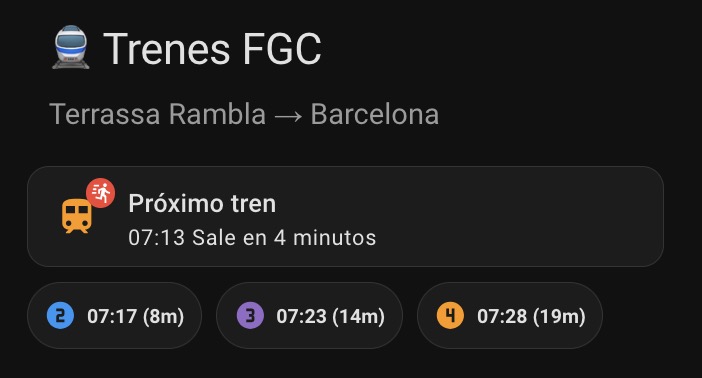

:camera_flash: What it looks like
The main card shows the next train with a countdown, and changes color based on how much time you have (red = run!, orange = hurry up, green = you’re good). There’s even a little running icon when you need to sprint. The chips below show the next 3 trains.
