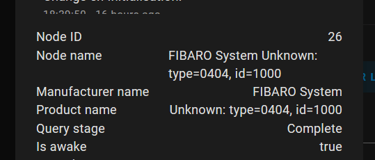

All installed and device was recognized in HASS but it shows up as Fibaro System Uknown: type=0404, id=1000

I have the same problem with the FGS-214 :
And more important, I can’t access to settings (like I do with other zwave devices), and I need to change the “Output Type” to “normally closed” for the setting 162, to manage my heaters).
The list doesn’t open, it’s “empty”.
