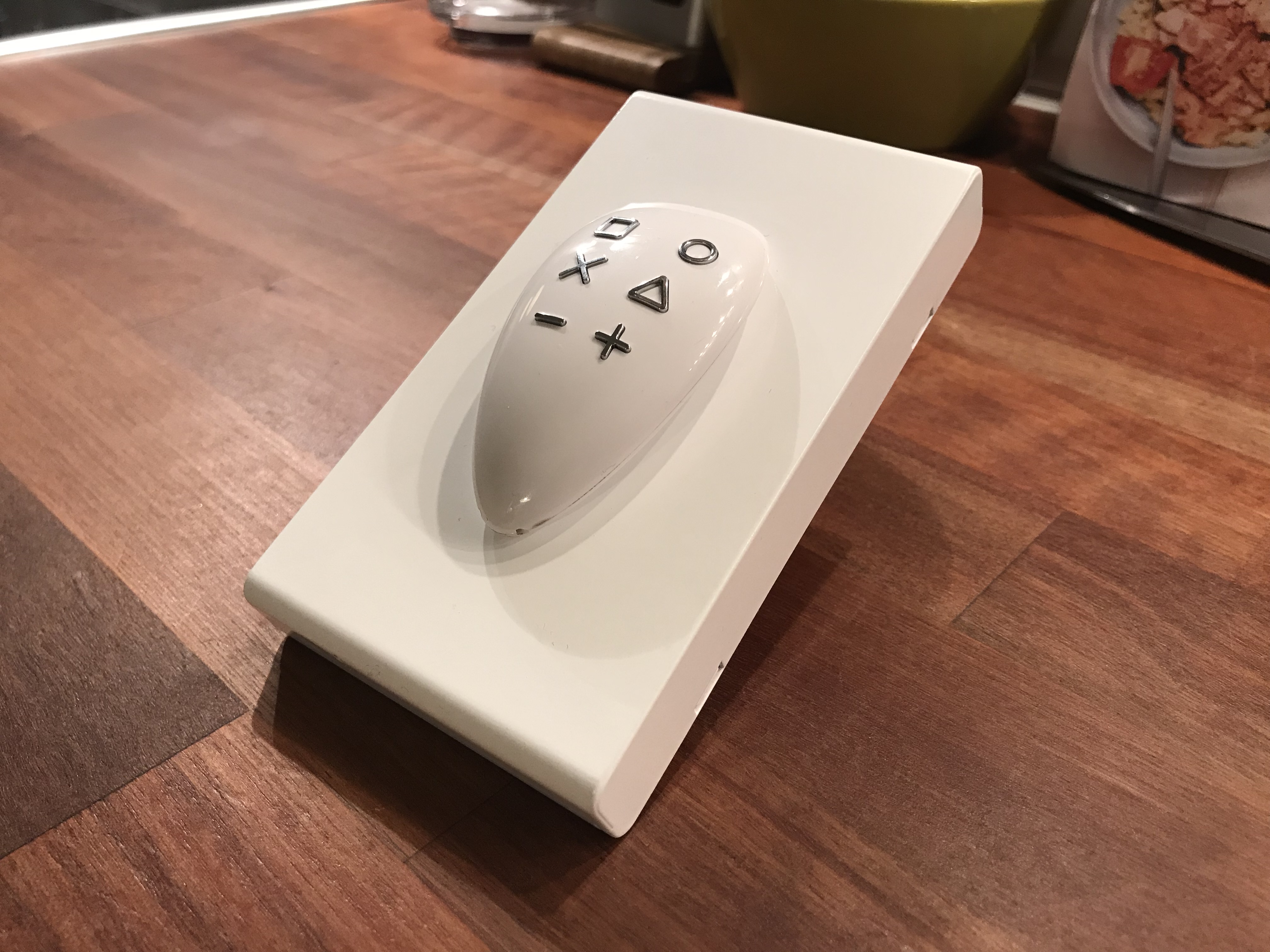

I just want to share this home made alarm control panel that I built by a Fibaro Keyfob and a battery box bought on eBay.
Before I tried to use a BeNext Tag Reader 500 but it was not working the way I wanted and it was to much hassle to set it up.
So this is what I came up with instead…
I’m using the Fiber Keyfob to active/deactivate the alarm by using scenes, or sequences as it says in the Keyfob manual.
I have configured one sequence to activate the alarm and on sequence to deactivate.

This has been working perfect but the only thing is that I can’t use tags, but I don’t mind.

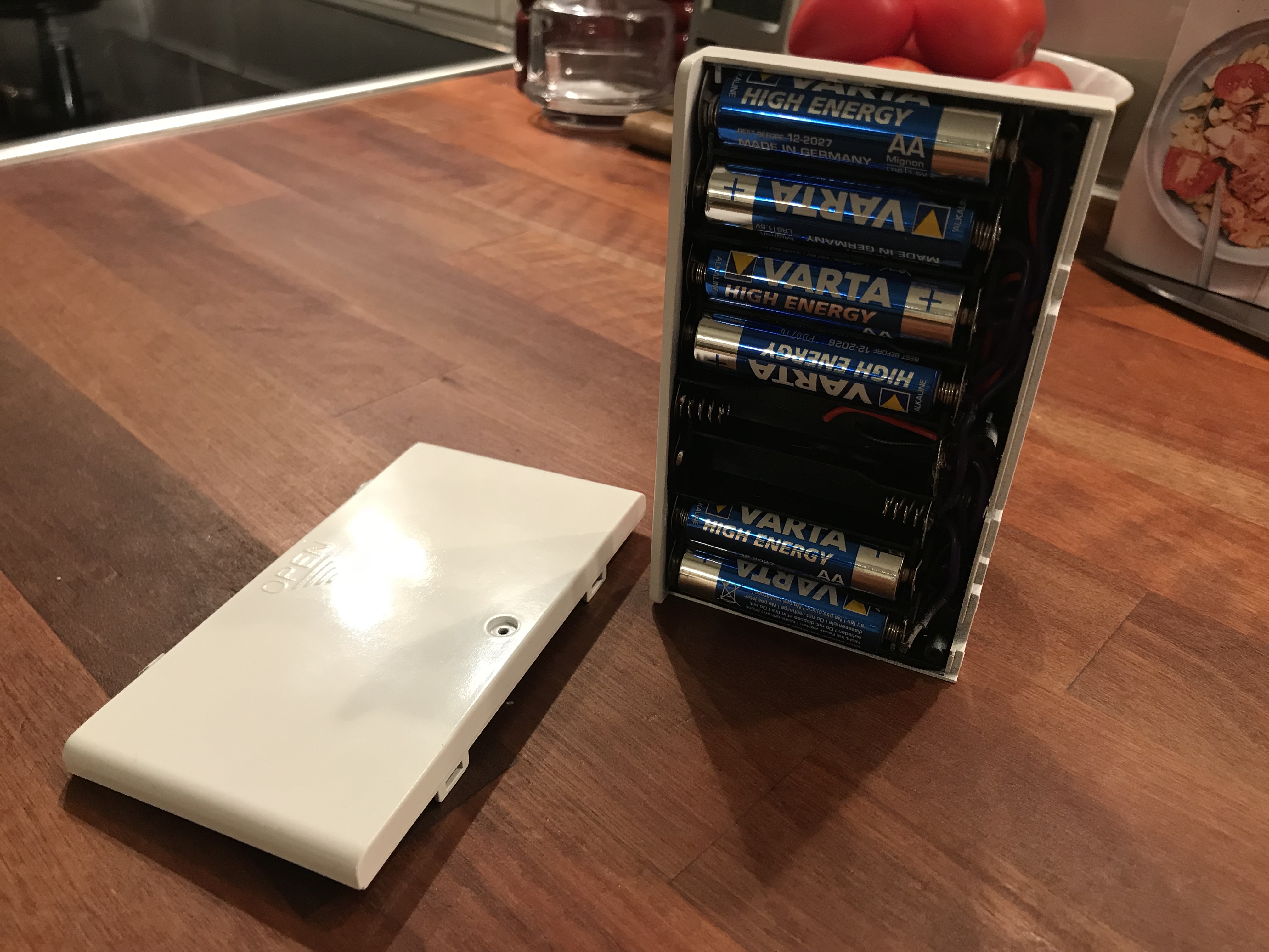

First I tried the Keyfob without the battery box but I thought it was draining the battery so I bought a battery box on eBay. This battery box will give you 12v so I had change this by solder the battery connections to output 3v. By using 2 batteries in series and in parallel with the other batteries this will give me power for some time.
