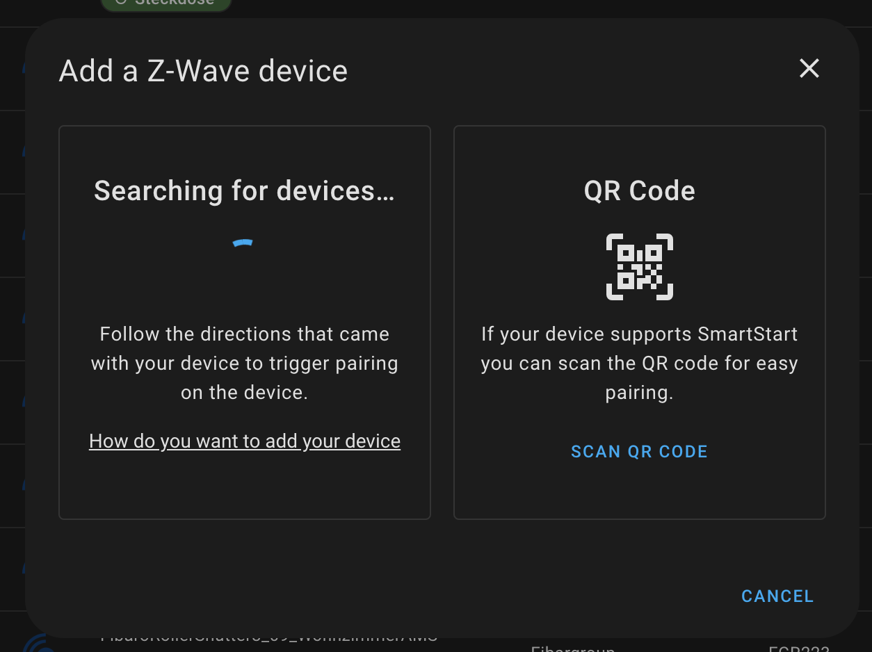

Could you in few words describe how did you manage to connect them to Home Assistant ? I’m trying to move from Fibaro HC-2 to HA, but I encounter a lot of up’s and down’s. One of the down’s is trying to connect Fibaro roller shutter to be invoked by Aqara switch.
In HA go to
Settings > Devices & service > Devices (devices tab on top) > Add device (right side blue button)
A Popup appreas:
Go to your Fibaro device (which is already connected to your wall switches & has power connection) and perform inclusion steps by quickly tripple click S1 (open)
go back to HA and enter the security PIN which is printed on Fibaro wall device
done
