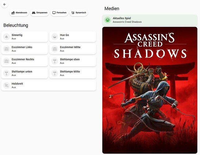

Finally I got it. The cover of the Xbox games currently playing on the Dashboard
Well, after a lot of sweat, frustration, work and learning a lot along the way, I finally have the cover of the Xbox game I am currently playing on my Dashboard. It has been complicated for me since I have been using Home Assistant for a few months but I finally have a first working version. I still want to improve it but I feel satisfied with the work done.
All it’s done with a few sensors, some api calls, an automation and a custom button card. Maybe I will do a step by step in the future with the final version.

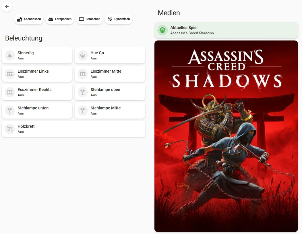

Hi all,
I was so inspired by the dashboard @d13g0m0nt3s initially shared, that I wanted to recreate the image entity showing the current playing Xbox game. I’m relatively new to HA, so my dashboard is not as pretty as the original by d13g0m0nt3s, but at least the image card is working :slight_smile:
I will briefly explain how I managed to get things working.
  • I expect you already have set up your Xbox integration. It’s necessary to enable the sensor sensor.your_gamertag.status. This sensor stores the game you’re currently playing and is disabled by default.
  • Create an account at GiantBomb and get your API key.
  • Create a virtual sensor in your configuration.yaml. This sensor will ask GiantBomb for the Game ID you’re currently playing via REST API and store it. Update the code with your own API and GamerTag Sensor you previously enabled. We will use this ID to ask for the image in the next step.
sensor:
  # Get Game ID
  - platform: rest
    name: "GiantBomb Game ID"
    resource_template: "https://www.giantbomb.com/api/search/?api_key=ENTER_YOUR_API_HERE&format=json&query={{ states('sensor.your_gamertag.status') | urlencode }}&resources=game"
    headers:
      User-Agent: "HomeAssistant"
    value_template: >
      {% if value_json.results is defined and value_json.results | length > 0 %}
        {{ value_json.results[0].id }}
      {% else %}
        none
      {% endif %}
    scan_interval: 604800
  • Create a virtual sensor in your configuration.yaml. Simply paste this code below the code from the previous step. This sensor will use the ID sensor and ask for the URL of the game’s artwork and store it. This URL sensor is later used in the dashboard. Update your API Key in this code as well.
    # Get Game Artwork
  - platform: rest
    name: "GiantBomb Game Artwork URL"
    resource_template: "https://www.giantbomb.com/api/game/{{ states('sensor.giantbomb_game_id' ) }}/?api_key=ENTER_YOUR_API_HERE&format=json"
    headers:
    value_template: >
      {% if value_json.results is defined and value_json.results.image is defined and value_json.results.image.screen_url is defined %}
        {{ value_json.results.image.super_url }}
      {% else %}
        none
      {% endif %}
  • The scan_interval is set to 604800 seconds which is equivalent to one week. So the sensor will update once a week. That’s no problem because we will now create the automation to update the sensors as soon as your GamerTag sensor changes its value.
  • Create a new automation and paste this YAML code into it. Update your GamerTag sensors so this automation will work for you as well. This automation is triggered by an update of your GamerTag status. Remember, this status stores the game you’re playing or how long you are offline, e.g. “Last seen 4h ago: Home”. As we don’t want hourly updates when you are not playing we use a condition to check if you are currently online. If yes, we will update the sensors that do the API calls for us.
alias: Xbox Game Artwork
description: ""
triggers:
  - entity_id:
      - sensor.your_gamertag.status
    trigger: state
conditions:
  - condition: and
    conditions:
      - condition: state
        entity_id: binary_sensor.your_gamertag
        state: "off"
actions:
  - target:
      entity_id: sensor.giantbomb_game_id
    action: homeassistant.update_entity
      entity_id:
        - sensor.giantbomb_game_id
  - delay: "00:00:02"
  - target:
      entity_id: sensor.giantbomb_game_artwork_url
    data: {}
  - delay: "00:00:02"
mode: single
  • Now it’s time to update your dashboard! I’m using a custom card from HACS because that works perfectly well with the URL from our sensor. The default HA card does not. Paste the YAML code into your dashboard whereever you want to have it.
type: custom:media-source-image-card
image: |
  {{ states('sensor.giantbomb_game_artwork_url') }}
forced_refresh_interval: 5
  • Optional:
    If you only want to display the image card when you are currently playing a game, use this code and paste it into the visibility option of the image card:
condition: state
entity: binary_sensor.gamertag # update here as well
state: "on"
So that’s it! I hope you could follow these steps and they helped you to recreate it for your own dashboard. Remember to update the code examples with your own API key and GamerTag. I’m not a native speaker so please excuse me if I have not expressed myself clearly enough. Feel free to ask in the comments!
