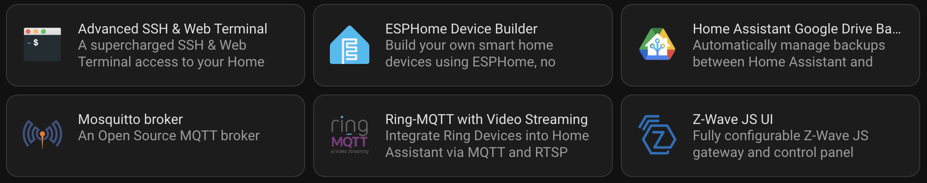

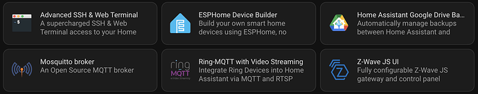

I’m only seeing that work some of the time. Any idea what’s the difference? I’m pulling the URL from the link on the add-on info page.
Here’s my add-ons:
Advanceed SSH: Hostname = a0d7b954-ssh * Not a match *
>>> hashlib.sha1("https://github.com/hassio-addons/addon-ssh".lower().encode()).hexdigest()[:8]
'319a9065'
ESP Home Hostname = 5c53de3b-esphome * Not a match *
>>> hashlib.sha1("https://esphome.io".lower().encode()).hexdigest()[:8]
'64a7cfe9'
Google Drive Backup Hostname = cebe7a76-hassio-google-drive-backup * MATCH *
>>> hashlib.sha1("https://github.com/sabeechen/hassio-google-drive-backup".lower().encode()).
'cebe7a76'
Ring MQTT Hostname = 03cabcc9-ring-mqtt * MATCH *
>>> hashlib.sha1("https://github.com/tsightler/ring-mqtt-ha-addon".lower().encode()).hexdigest()[:8]
'03cabcc9'
Z-Wave JS UI Hostname = a0d7b954-zwavejs2mqtt * Not a match *
>>> hashlib.sha1("https://github.com/hassio-addons/addon-zwave-js-ui".lower().encode()).hexdigest()[:8]
'b6898ad4'
You must use different urls:
URL:
https://github.com/hassio-addons/repository
SHA1:
a0d7b954840a8807d9cf9a06fb8d685f67d1c7ab
URL:
https://github.com/esphome/home-assistant-addon
SHA1:
5c53de3b0e4baaf5d250ed77de4b81e1a2932758
Oh, thanks. I didn’t see those repos listed anywhere so followed the “Visit” links on the add-on’s Info page. Did I miss where the repo is listed for a given add-on?
