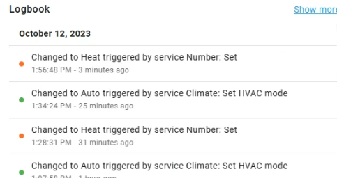

I have three new zigbee thermostats, that are set up with Zigbee2MQTT.
Two of them do what I say - they turn on and off as I command.
But the thirs one keeps changing its value:
Can I somehow find out where this change is coming from? I have searched my HA installation but found nothing.
One thing: I tried to set the thermostats up with Better Temperature – but removed this integration due to it not working.
Thank you all very much!
Best regards,
Sven
To prevent questions about temp setting - it keeps heating although i set it to low temp:
This might be the same issue (in that case Eve Thermo Thread/Homekit TRVs with Versatile Thermostat integration) radiator valve stuck in loop ("changed to heat / turned off / … triggered by service Climate: Set HVAC mode") until HA reboot · Issue #121 · jmcollin78/versatile_thermostat · GitHub Edit: just realised that in the case above the change don’t happen multiple times per second but much more infrequent.
So me again - sometimes it helps just to talk.
I decided to remove all TRVs from Zigbee and HA and add them new.
It seems there were some remnants of BetterThermostat left in the system that kept changing my settings.
I have been watching now for some minutes and at first glance it seems to work now.
I will keep wathcing it – and thanks to everybody that read my first post and thought about my problem!
