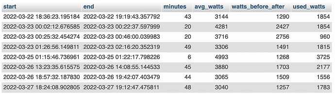

This found the average watts used while the dryer’s accelerometer is moving and the average of the watts reported 10 minutes before and 10 minutes after. I limited it to states created after March 22 so you may need to change this. The results look like this:
