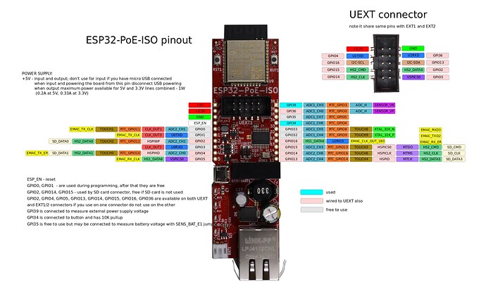

Nice job. Im doing some research to see if I can use a PoE ESP32 board (this one) to do the job. I guess I can, but I have no clue how I need to wire them (see picture for board info) and to edit your config to make everything work.
Ps. I dont need the chime and doorbell as I have that already settled.
  # GPIO Pins
  uart_tx_pin: GPIO25        # R503 green (or purple) wire
  uart_rx_pin: GPIO27        # R503 yellow wire
  sensing_pin: GPIO32        # R503 blue wire
  lock_relay_pin: GPIO16
  chime_relay_pin: GPIO17
  door_sensor_pin: GPIO18
@fleeman :slightly_smiling_face:
Happy to see if someone can guide me through :slight_smile:
