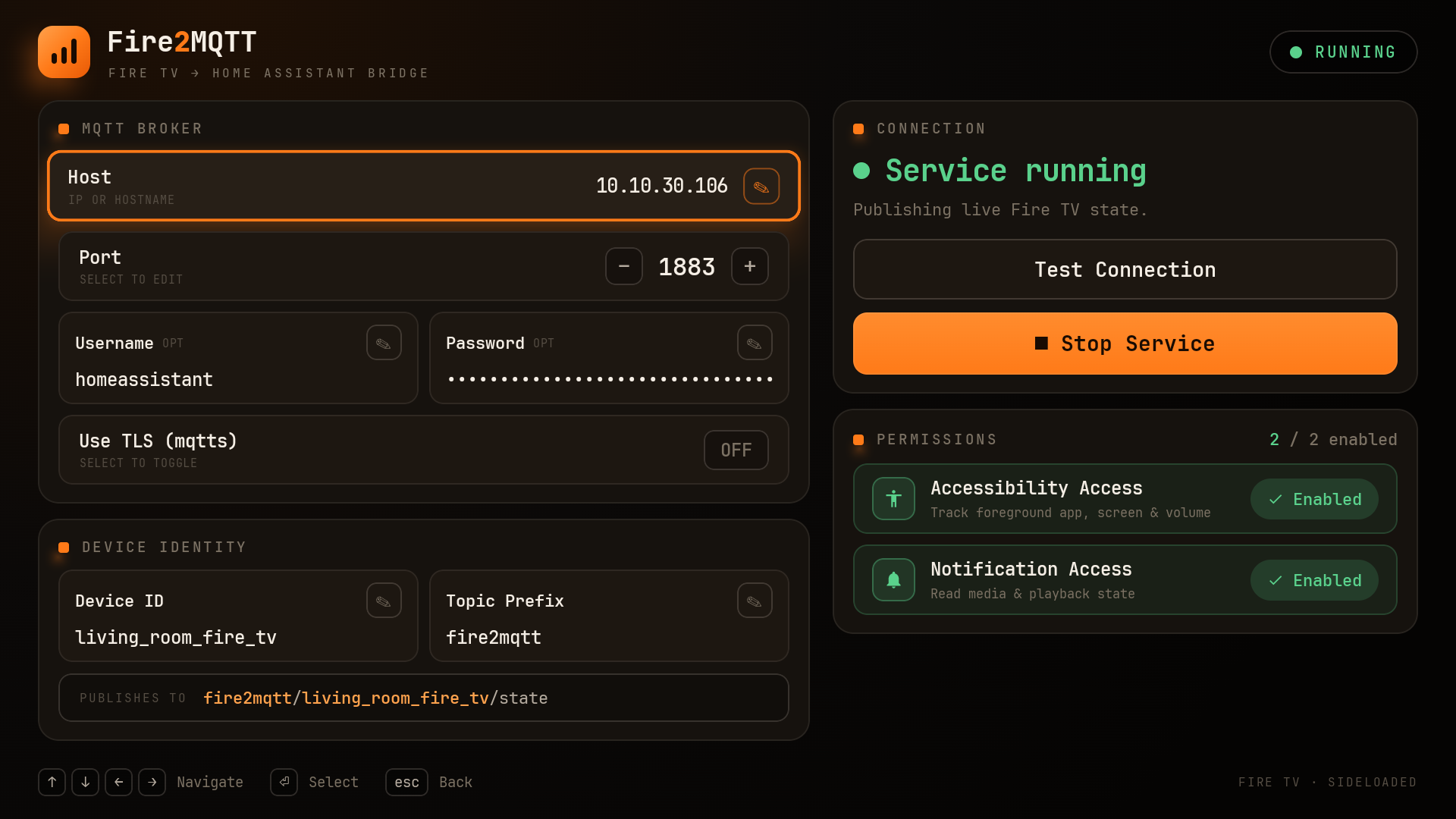

I've built Fire2MQTT, a Home Assistant integration for Fire TV Sticks that skips the usual ADB-polling approach. A small sideloaded app watches the stick's playback/app/screen/volume state and pushes changes over MQTT the instant they happen, so HA gets a real media_player, sensors, a remote, and app-launch controls with sub-100ms latency.
Setup is one HACS config flow, point it at your Fire TV's IP and MQTT broker, and it installs the APK and wires everything up for you.
