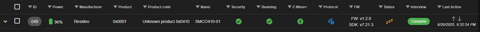

Pairing was a bit of a chore but that’s now complete. The issue I’m having is that although the device was detected, paired, and shows sensors, the information shown in Z-Wave JS is incomplete…
Specifically…
Product: 0x0001
Product Code: 0x0410
I found the Z-Wave JS Config DB Browser and I don’t find the SMCO410 under the manufacturer being detected (Resideo) nor do I find it anywhere else in the database. I’ve searched and can’t find the process to request the addition of a new device to the database. I’m hoping someone can point me to the right place.

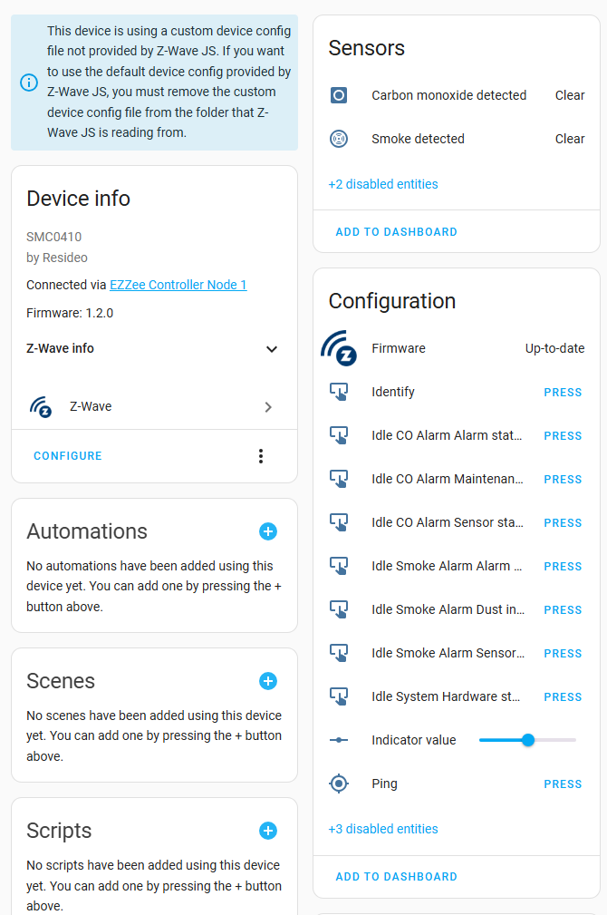

I happen to have purchased the same device from Amazon and modified the old ZCOMBO configuration file to work with this one. There aren’t significant differences thankfully as it has the same configuration parameters. The changes came from data for the device at the Z-wave Alliance web site.
You can create a SMCO410.json file in the config folder and paste in these contents. Restart Z-wave-JS UI or just change the configuration and hit save and the file will be read.
Once you include the new device it should look like this:

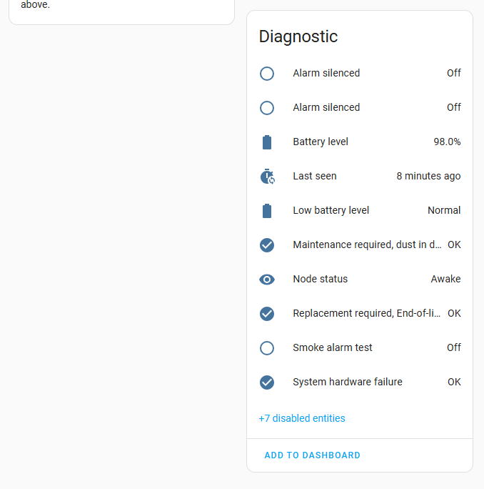

And in Home Assistant these are the default entities:
Here’s the config file:
