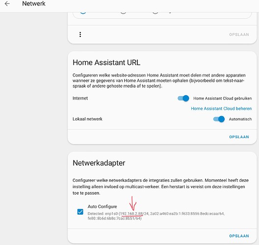

Different ways. If you attach a monitor to the pi, it will show the ip at the console. But since you can access HA from the mac: I can see mine at the settings, network, at the bottom of the page after the ethernet adapter:
so for me, the url is http://192.168.2.88:8123/
