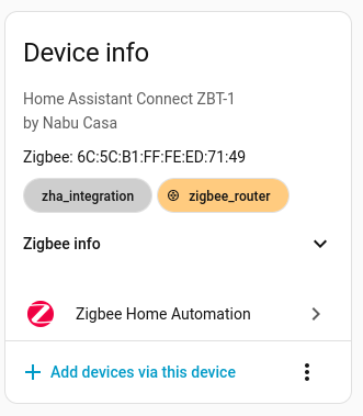

I have a ZBT-1 and the Frient electricity meter - been working fine for a couple of years.
Assuming the ZBT-2 works in the same way as its predecessor (I imagine it does, the integration’s the same), you should use the Zigbee Home Automation integration to pair a device.
Click on the Zigbee Coordinator in the device list, then in the “Device Info” box, click on “Add devices via this device” to start pairing.
