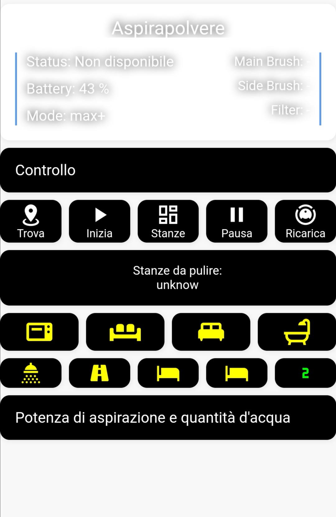

Hi Stefano,
I would also be interested in solving this problem
writing in the yaml (where input_boolean are shown) the code:
input_text:
valuestanze:
idstanze:
the card shows the message “stanze da pulire: unknow”
Stefano, only you can help us solve and understand the error!
We are waiting for you
Thanks in advance
