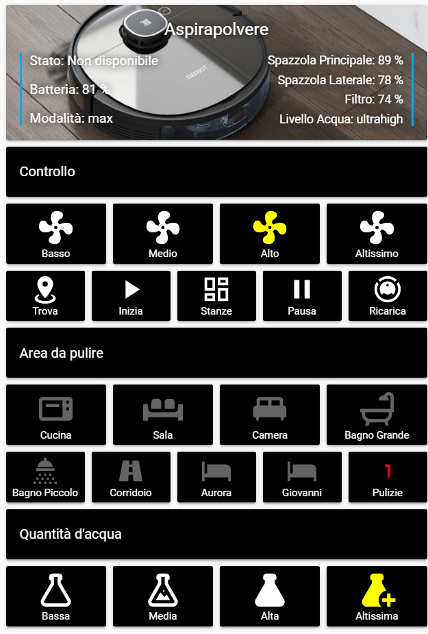

Thanks for all of the hard work that went into making this, I have a 920 and I have managed to get it working no problem.
Next step is to get a nice UI up and running like some of the examples (and replace the horrible app for most basic functions). I saw some mention of being able to use co-ordinates with the spot cleaning function - can anyone help me with how I can find these out for my map?
Struggling with how to get the brush and filter percentage displayed in the main image at the top of the card. I used KEM_Hass’ card. I’m using a Deebot 901 with location as US, NA. Appreciate any help, I’m not seeing where to add the attributes in the xiaomi card.
Ciao stefano sto seguendo un po’ questa tua discussione per creare una card ocme le vostre, sono riuscito in parte a fare tutto, ma ho fatto quella come l’altro ragazzo mentre la tua e piu completa, mi passeresti la tua card? Mi piacciono tutte quelle info che ci sono nella tua.
dove bisogna inserire queste righe di ocmando per avere il colore variabile?
Stefano, thanks for all the work
I’m trying to implement the map but your instructions are not really clear :slight_smile: Where do I need to paste the code you provided?
@Gabriele_Mandalari @StefanoGiu
Good job!
Could you share your card with all the related codes to make it work properly?
Fantastic the possibility to change the color according to the chosen option and also to be able to decide the cleaning areas.
As many of you asked about the configuration I used, please find below:
Lovelace:
                    var stanze = states['input_text.valuestanze'].state;
                    stanze = stanze.substring(0,stanze.length - 1);
                    return "Stanze da pulire: <br>" + stanze;
            styles:
              card:
                - font-size: 13px
                - background-color: black
                - color: white
              name:
                - width: 100%
                - align: 'left'
                - justify-self: start
                - padding-left: 10px
                - word-wrap: anywhere
            type: 'custom:button-card'

                            - color: white
                        tap_action:
                          action: call-service
                          service: vacuum.send_command
                          service_data:
                            command: set_water
                            entity_id: vacuum.aspirapolvere
                            params:
                              amount: ultrahigh
            type: horizontal-stack
        type: vertical-stack
      - card:
          entity: sensor.deebot_last_clean_image
          image: '${states[''sensor.deebot_last_clean_image''].state}'
          type: 'custom:hui-image-element'
          - sensor.deebot_last_clean_image
        style:
          height: 5%
          left: 35%
          top: 45%
          transform: 'translate(0%,2%)'
          width: 5%
        type: 'custom:config-template-card'
    path: aspirapolvere
    title: Aspirapolvere
Script:
vacuum_clean_zone:
  alias: Pulisci zona
  sequence:
  - service: vacuum.send_command
    data_template:

Modified xiaomi-vacuum-card.js
((LitElement) => {
    const html = LitElement.prototype.html;
    const css = LitElement.prototype.css;
    class XiaomiVacuumCard extends LitElement {
        static get properties() {
            return {
                _hass: {},
                _config: {},
                stateObj: {},
                state: {},
                style: {}
        static get styles() {
            return css`
        .background {
          background-repeat: no-repeat;
          background-position: center center;
          background-size: cover;
        .title {
          font-size: 20px;
          padding: 16px 16px 0;
          text-align: center;
          white-space: nowrap;
          text-overflow: ellipsis;
          overflow: hidden;
        .content {
          cursor: pointer;
        .flex {
          display: flex;
          align-items: center;
          justify-content: space-evenly;
        .button {
          cursor: pointer;
          padding: 16px;
        .grid {
          display: grid;
          grid-template-columns: repeat(2, auto);
        .grid-content {
          display: grid;
          align-content: space-between;
          grid-row-gap: 6px;
        .grid-left {
          text-align: left;
          font-size: 110%;
          padding-left: 10px;
          border-left: 2px solid var(--primary-color);
        .grid-right {
          text-align: right;
          padding-right: 10px;
          border-right: 2px solid var(--primary-color);
        render() {
            return html`
            <ha-card .hass="${this._hass}" .config="${this._config}" class="background" style="${this.style.background}">
              ${this.state.name ?
                html`<div class="title" style="${this.style.text}" @click="${() => this.fireEvent('hass-more-info')}">${this.state.name}</div>`
                : null}
              ${this.state.showLabels ? html`
              <div class="content grid" style="${this.style.content + this.style.text}" @click="${() => this.fireEvent('hass-more-info')}">
                <div class="grid-content grid-left">
                  <div>${this.getValue('vacuum_status')}</div>
                  <div>${this.getValue('battery', ' %')}</div>
                  <div>${this.getValue('mode')}</div>
                </div>
                ${this.state.showDetails ? html`
                <div class="grid-content grid-right" >
                  <div>${this.getValue('main_brush', ' %')}</div>
                  <div>${this.getValue('side_brush', ' %')}</div>
                  <div>${this.getValue('filter', ' %')}</div>
                  <div>${this.getValue('water_level')}</div>
                </div>` : null}
              </div>` : null}
              ${this.state.showButtons ? html`
              <div class="flex" style="${this.style.text}">
                ${Object.keys(this.state.buttons).map(this.renderButton.bind(this))}
              </div>` : null}
            </ha-card>`;
        renderButton(key) {
            return this.state.buttons[key]
                ? html`<div class="button" @tap="${() => this.callService(key)}"><ha-icon icon="${this.state.icons[key]}"></ha-icon></div>`
                : null;
        getValue(field, unit = '') {
            const value = (this.stateObj && this.state.attributes[field] in this.stateObj.attributes)
                ? this.stateObj.attributes[this.state.attributes[field]] + unit
                : (this._hass ? this._hass.localize('state.default.unavailable') : 'Unavailable');
            return `${this.state.labels[field]}: ${value}`;
        computeValue(field) {
            if (this.state.attributes[field] === undefined || this.state.attributes[field] === false) {
                return null;
            } else if (this.stateObj && this.state.attributes[field] in this.stateObj.attributes) {
                const computed = this.state.computeValue(this.stateObj.attributes[this.state.attributes[field]]);
                const unit = typeof computed === 'number' ? ` ${this.state.labels.hours}` : '';
                return `${this.state.labels[field]}: ${computed}${unit}`;
            } else {
                return `${this.state.labels[field]}: - `;
        callService(service) {
            this._hass.callService('vacuum', this.state.service[service], {entity_id: this.stateObj.entity_id});
        fireEvent(type, options = {}) {
            const event = new Event(type, {
                bubbles: options.bubbles || true,
                cancelable: options.cancelable || true,
                composed: options.composed || true,
            event.detail = {entityId: this.stateObj.entity_id};
            this.dispatchEvent(event);
        getCardSize() {
            if (this.state.name && this.state.showButtons) return 5;
            if (this.state.name || this.state.showButtons) return 4;
            return 3;
        setConfig(config) {
            const labels = {
                vacuum_status: 'Stato',
                battery: 'Batteria',
                mode: 'ModalitĂ ',
                main_brush: 'Spazzola Principale',
                side_brush: 'Spazzola Laterale',
                filter: 'Filtro',
                water_level: 'Livello Acqua',
                hours: 'h',
            const attributes = {
                vacuum_status: 'vacuum_status',
                battery: 'battery_level',
                mode: 'fan_speed',
                main_brush: 'component_brush',
                side_brush: 'component_sideBrush',
                filter: 'component_heap',
                water_level: 'water_level',
            const services = {
                start: 'start',
                pause: 'pause',
                stop: 'stop',
                locate: 'locate',
                return: 'return_to_base',
                spot: 'clean_spot',
            const buttons = {
                start: true,
                pause: true,
                stop: true,
                spot: false,
                locate: true,
                return: true,
            const icons = {
                start: 'mdi:play',
                pause: 'mdi:pause',
                stop: 'mdi:stop',
                locate: 'mdi:map-marker',
                return: 'mdi:home-map-marker',
                spot: 'mdi:broom',
            const vendors = {
                xiaomi: {
                    details: true,
                valetudo: {
                    details: true,
                    attributes: {
                        main_brush: 'mainBrush',
                        side_brush: 'sideBrush',
                        filter: 'filter',
                        sensor: 'water_level',
                roomba: {
                    details: true,
                    attributes: {
                        main_brush: 'bin_present',
                        side_brush: 'bin_full',
                        filter: false,
                        sensor: false,
                    labels: {
                        main_brush: 'Bin Present',
                        side_brush: 'Bin Full',
                    computeValue: v => (v === true ? 'Yes' : (v === false ? 'No' : '-')),
                robovac: {
                    details: false,
                    buttons: {
                        stop: false,
                        spot: true,
                ecovacs: {
                    image: '/local/img/vacuum_ecovacs.png',
                    details: false,
                    buttons: {
                        stop: false,
                        spot: true,
                    service: {
                        start: 'turn_on',
                        pause: 'stop',
                        stop: 'turn_off',
                deebot: {
                    details: true,
                    service: {
                        start: 'turn_on',
                        pause: 'stop',
                        stop: 'turn_off',
                    attributes: {
            if (!config.entity) throw new Error('Please define an entity.');
            if (config.entity.split('.')[0] !== 'vacuum') throw new Error('Please define a vacuum entity.');
            if (config.vendor && !config.vendor in vendors) throw new Error('Please define a valid vendor.');
            const vendor = vendors[config.vendor] || vendors.xiaomi;
            this.state = {
                showDetails: vendor.details,
                showButtons: config.buttons !== false,
                showLabels: config.labels !== false,
                showName: config.name !== false,
                service: Object.assign({}, services, vendor.service),
                buttons: Object.assign({}, buttons, vendor.buttons, config.buttons),
                attributes: Object.assign({}, attributes, vendor.attributes, config.attributes),
                labels: Object.assign({}, labels, vendor.labels, config.labels),
                icons: Object.assign({}, icons, config.icons),
                computeValue: vendor.computeValue || (val => val),
            this.style = {
                text: `color: ${config.image !== false ? 'white; text-shadow: 0 0 10px black;' : 'var(--primary-text-color);'}`,
                content: `padding: ${config.showButtons ? '16px 16px 4px' : '16px'};`,
                background: config.image !== false ? `background-image: url('${config.image || vendor.image || '/local/img/vacuum.png'}')` : ''
            this._config = config;
        set hass(hass) {
            this._hass = hass;
            if (hass && this._config) {
                this.stateObj = this._config.entity in hass.states ? hass.states[this._config.entity] : null;
                if (this.stateObj && this.state.showName) {
                    this.state.name = this._config.name || this.stateObj.attributes.friendly_name;
    customElements.define('xiaomi-vacuum-card', XiaomiVacuumCard);
})(window.LitElement || Object.getPrototypeOf(customElements.get("hui-view")));
Thanks Stefano for sharing your excellent work.
