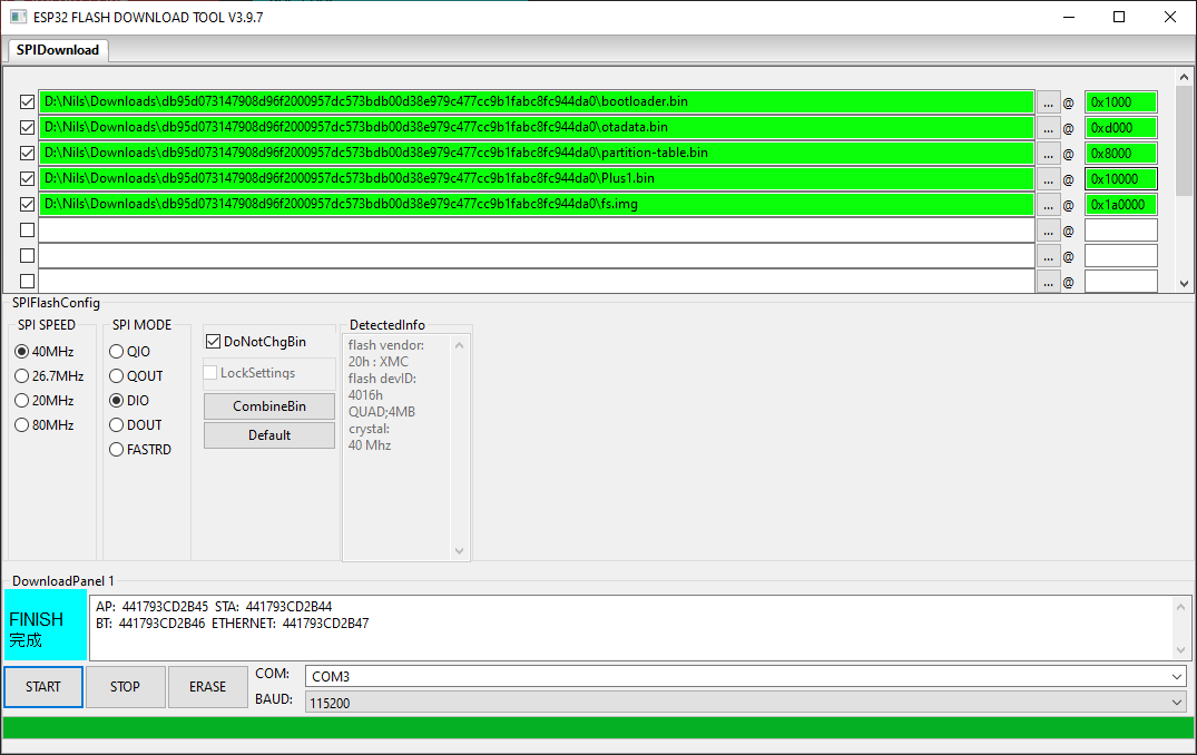

Step 2 the ESP32 Flash Download Tool is necessary
Step 3 I then loaded the 5 files (.bin or .img) into the tool and set the addresses as I took them from the Manifest.json. Unfortunately, it only contains the addresses for the bootloader and the partitioning.
When I tried to flash the files, I got the message that the files were overlapping. I then simply flashed them individually. This of course caused the esp to not work properly and constantly reset, but I was able to see the partition table in the serial port.
Step 4 From the serial port I then took the addresses for otadata.bin, Plus1.bin (is then “app_0 / OTA app” in the console) and fs.img (is then “fs_0 / FS” in the console). I then set these addresses in the Flash tool and successfully transferred the firmware.
The addresses for flashing were in my case as you can see in the picture
bootloader.bin 0x1000
partition-table.bin 0x8000
otadate.bin 0xD000
Plus1.bin 0x10000
fs.img 0x1a0000
although this may not seem to me to be the final solution, as I still have problems integrating it into the HA add-on and I have the following log entries in the diagnostics
shelly_factory_data:111 Could not open factory data partition: 4354 23:24:11
shelly_factory_data.:37 Factory data missing or version -1 unsupported 23:24:11
shelly_factory_data:204 UNABLE TO LOAD FACTORY DATA 23:24:11
this could be logical, as the factory data may have been overwritten by the previous programming and does not appear to be included in the updates. i will probably find out over time whether this is a problem in operation.
