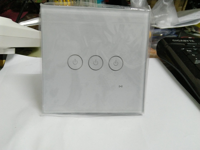

Thereâs no empty holes on the pcb, but you can see the tx,rx,gnd & 3v3, labeled here
Itâs another itead based wall switch that comes with 2/3 gangs
More info on this thread
Unfortunately,looks as if for that switch soldering is required unless youâre an octopus with perfectly still hands/tentacles

Good news is the 3 gang switch I ordered just arrived today and itâs using the PSF-B85 (ESP8285)
https://www.itead.cc/psf-b85.html
https://www.itead.cc/wiki/PSF-B85
Is this similar to the one on Sonoff Touch?
Could need some help how to spot the rx,tx,3v3 & gnd for this board.
You can view the rest of the pics here
