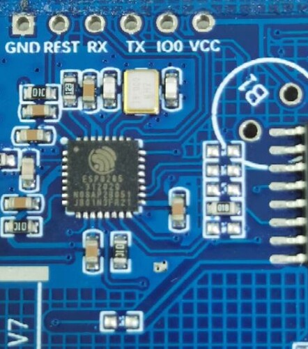

This is how the board looks like,

You can either do trail and error method or trace the leads from the relay signal pin. You should end this trace in a gpio pin and from the schematics of the chip you should be able to find the relay gpio.
well the chances are less as all these pins are equipped to handle 3.3v so in theory even if you mess up it should not fry the chip. And you will be able to reflash it but then againeven when the chances are low they do get messed up.
