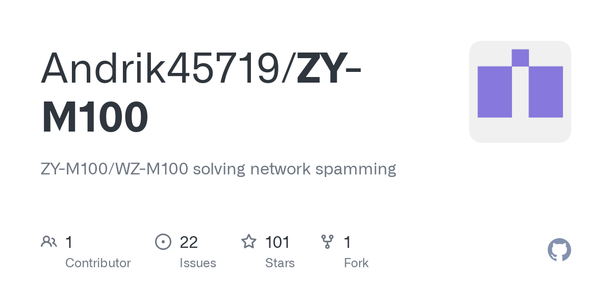

The cheap Wenzhi ZY-M100 sensor seems quite popular, especially since it seems they’re actually the only ones you can fit into the ceiling. However as noted by many, these sensors spam a lot. But there’s a solution that I came across and I felt it needed more attention here, since this really is nice. This guy patches several Wenzhi sensors. After flashing those the spamming is pretty much gone: GitHub - Andrik45719/ZY-M100: ZY-M100/WZ-M100 solving network spamming

Hey, yeah it’s on Andrik’s page:
However if I remember correctly, SWDIO and SWCLK have to be swapped for that sensor. But you can try both and see which works.
