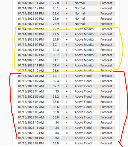

One feature I would love to see supported as I do not know how (without writing custom javascript) one could do it today. Maybe it could be done with modify, but I am not sure. I have a sensor that contains the flood level of (really any) NOAA tracked river. It parses the data from CSV into this sensor. See Create graph/automation based on river level - #8 by kbrown01 for more information.
What I want to achieve is to colorize row(s) based on some content. That said, I would think some generic solution that allowed for row color or cell color based on content would be ideal. If you see this real data:
The yellow area is “Above Monitor”, the red area “Above Flood”. I would welcome any solution that would allow me to colorize the rows (or even the cells but that is not ideal). Right now I have this.

I was thinking of some YAML that would allow a person to specify that the column should also have the data in a @data-vaue attribute and that could be used with CSS to color specific cells. Perhaps it could be done with modify though.
To answer my own question (well at least half of it), I can do cells like this:

And to re-answer my question with enhancements:
type: custom:flex-table-card
  include: sensor.russian_river_flood_info
columns:
  - name: Date/Time
    data: flooddata
    modify: x.valid
  - name: Level
    data: flooddata
    modify: |-
      switch(x.status){
        case 'Above Monitor':
          '<div style="background-color:  #e67300;">' + parseFloat(x.level).toFixed(1) + '&nbsp;ft</div>';
          break;
        case 'Above Flood':
          '<div style="background-color: #cc0000;">' + parseFloat(x.level).toFixed(1) + '&nbsp;ft</div>';
          break;
        default:
          parseFloat(x.level).toFixed(1) + '&nbsp;ft';
    align: center
  - name: Trend
    data: flooddata
    modify: |-
      switch(x.trend){
        case '+':
          '<ha-icon icon="mdi:arrow-up" style="color:  #e67300;">';
          break;
        case '-':
          '<ha-icon icon="mdi:arrow-down" style="color:  #3399ff;">';
          break;
        default:
          '<ha-icon icon="mdi:arrow-all">';
    align: center
Now, move onto a better solution than scrolling the whole table which is terrible. The scrolling posted above in the author’s samples will not suffice. A table should scroll the body and not the whole table. Should be able to do that in pure CSS
