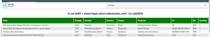

Hi, I am hoping someone can help me with the flex-table-card operation as I just can’t get my head around the issue I have.
I am extracting the aircraft data from my raspPi which I can get from the received html data in Node Red (http://192.168.1.126:8080/data/aircraft.json). I have manipulated that data to remove any incomplete datasets and then I can receive each aircraft as a single payload with the attributes I want. That fills only 1 horizontal row, but nothing more as. it just overwrites until the last item.
(example sensor with attributes).
![snip1](https://community-assets.home-assistant.io/original/4X/0/a/2/0a2e623ed5ec53163af63112a4fa7ff89fb68836.jpeg)
Reading a bit more I can see the data needs to be an array to fill subsequent rows, so I have joined each message as an array, but now I am stuck as I don’t know how to send this information to the HA flex card
