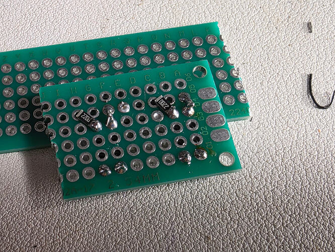

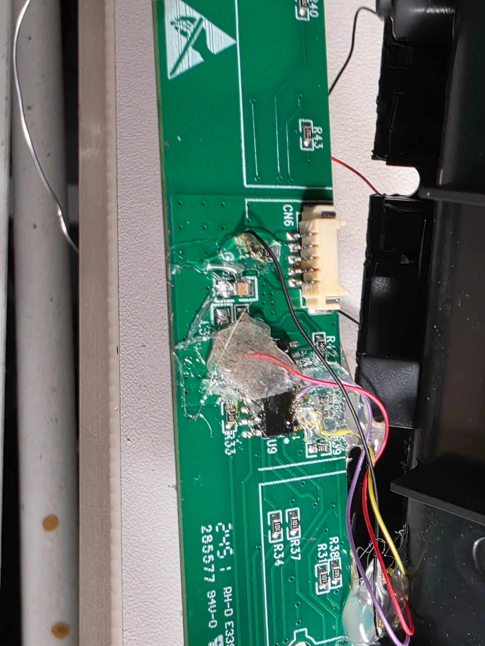

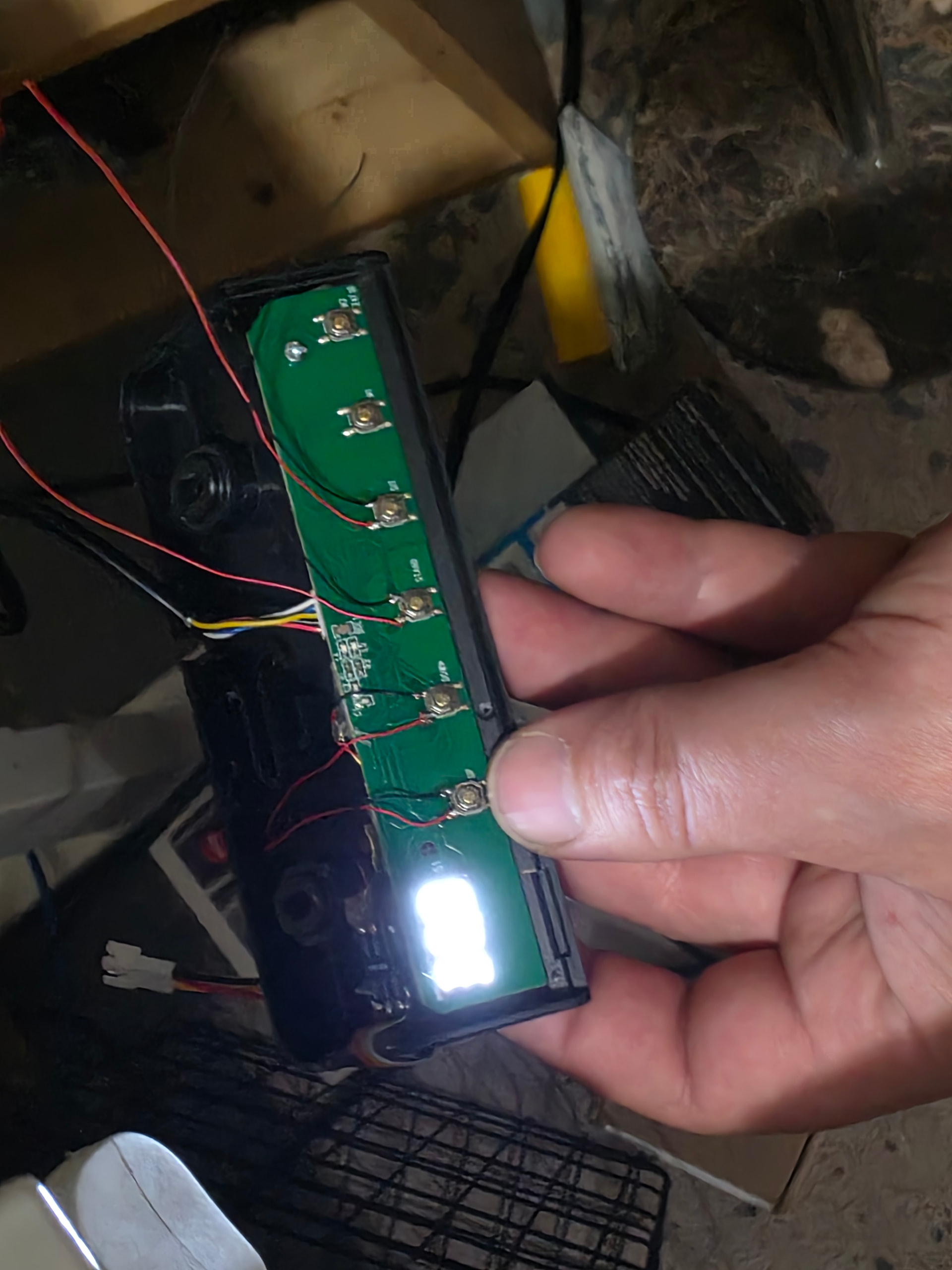

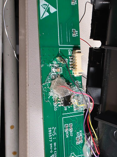

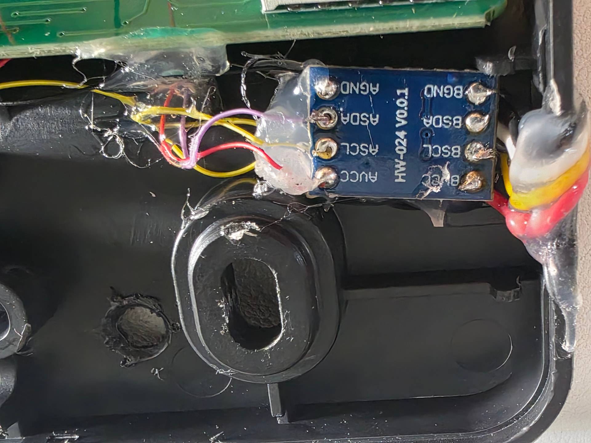

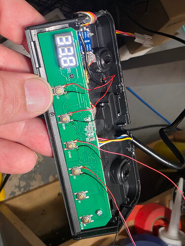

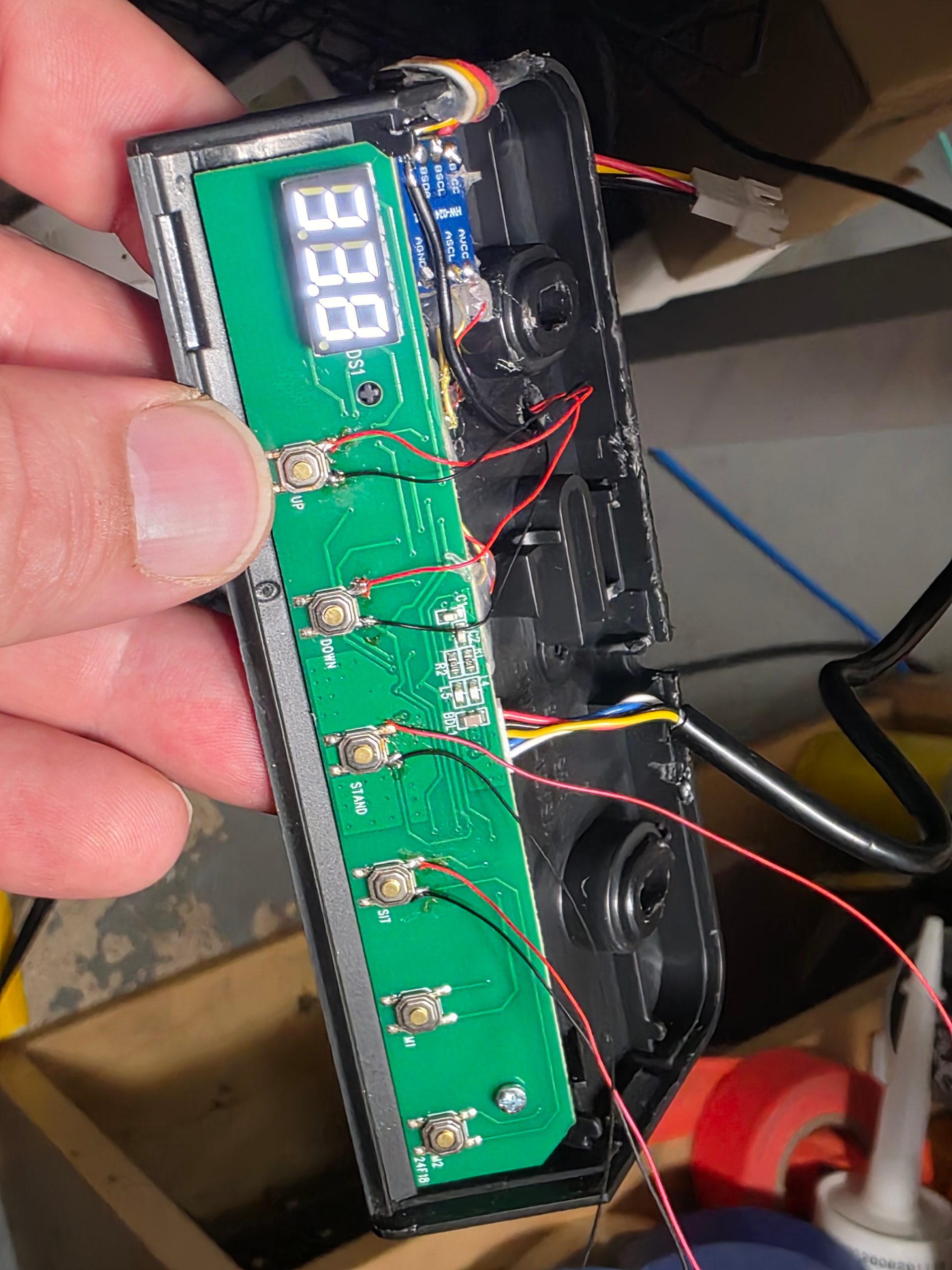

The cheaper FlexiSpot (LokTek Motion) desks use controllers that are hardwired. I used pc817 optocouplers for button presses and am using an i2c interrupt handler to try and read the segment display.
This did require fine soldering, so I wouldn't recommend for users that don't have some experience in soldering. Specifically the 2 pins on the LED driver for i2c CLK and DATA. I used single core 30 AWG to tap into the LED driver.

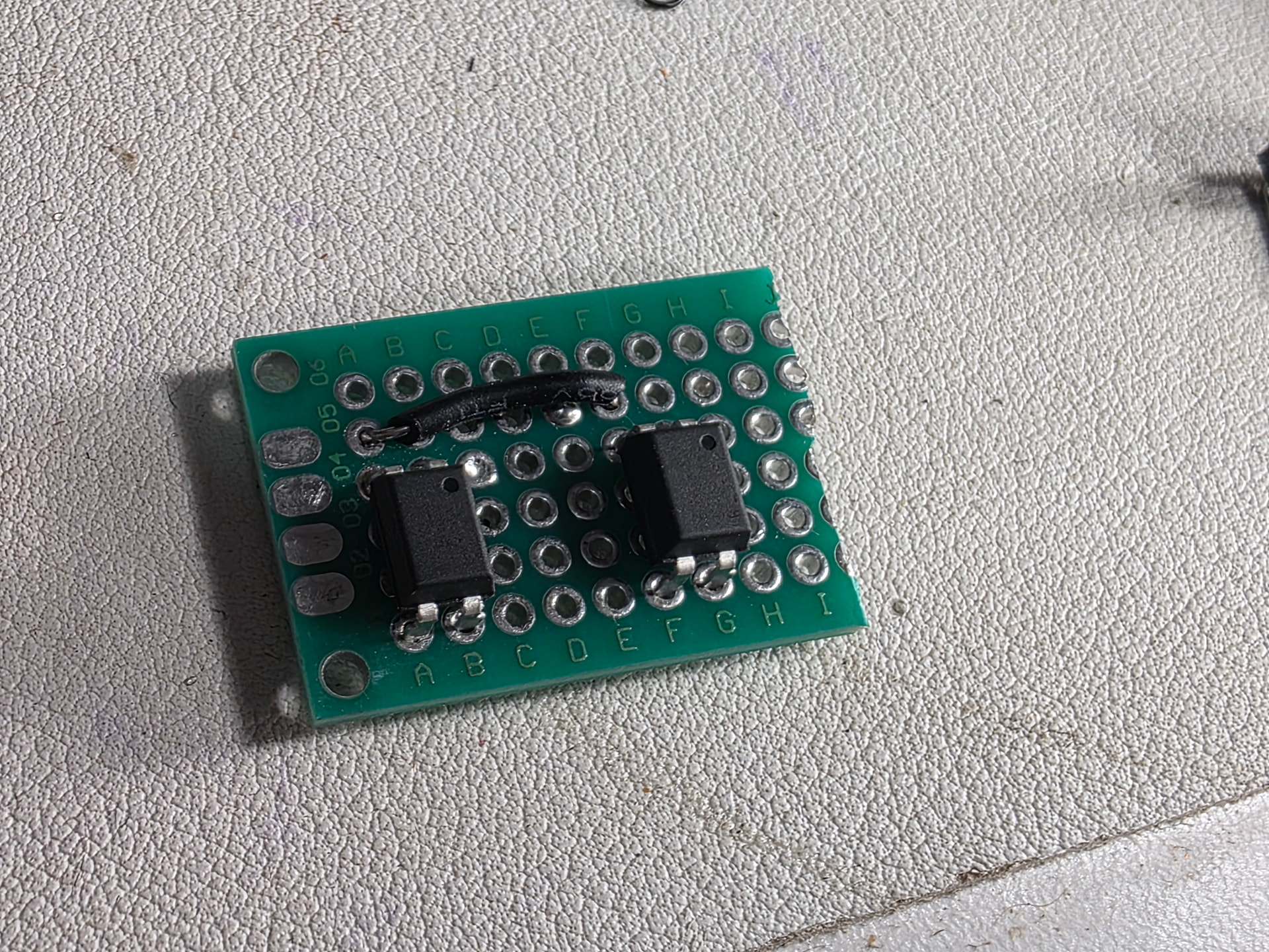

BOM:
  • esp32-c3 super mini
  • 220 - 330 ohm resistors for pin 1 on pc817 to limit current x4
  • pc817 optocouplers x4 (up, down, stand, sit)
  • i2c logic level converter HW-024
  • 1n5817 Schottky diode to protect esp32 3.3v pin from back feeding from the HW-024. Cathode (stripe) towards the HW-024 low voltage VCC pin.
Note: the +5vdc pin for the momentary switch goes to pin 4 on the pc817.

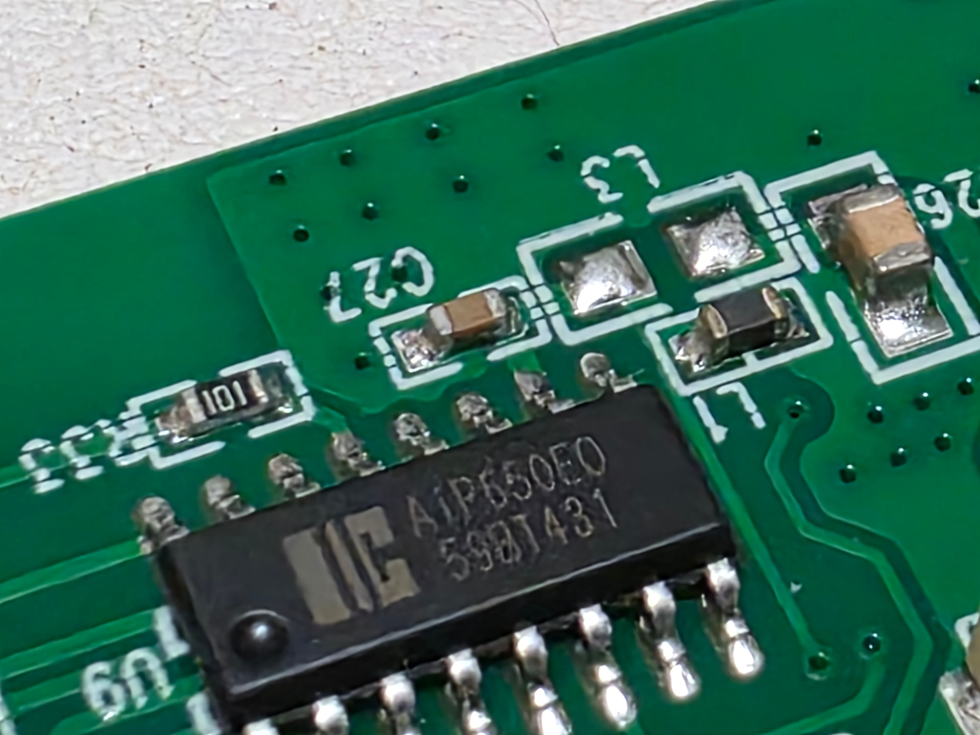

I have it reading the height from the 7-segment display.
I had to write some custom code to interface with the AIP650E0 IC, it uses I2C but its own version. The HW-024 was too slow, as this custom I2C runs at a higher frequency than standard; it created a lot of noise. The fix that’s working for me so far is some 1N5817 diodes with pull-up resistors to the 3.3V line; cathode towards the desk controller IC. I may try and use a 6N137 instead. When I clean the wiring up, I will add a new reply with the final BoM and schematic.

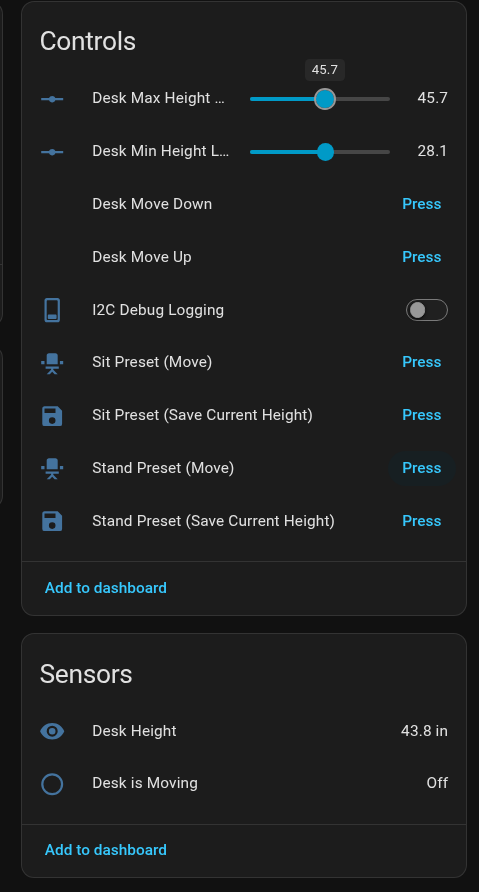

example esphome config
external_components:
  - source:
      type: local
      path: custom_components
  - platform: desk_sniffer
    scl_pin: 3
    sda_pin: 2
    debug_switch:
      name: "I2C Debug Logging"
    accuracy_decimals: 1
    unit_of_measurement: in
    on_value:
        - binary_sensor.template.publish:
            state: ON
        - script.execute: reset_moving_timer
    pin: 4
    restore_mode: ALWAYS_OFF
    internal: true
    pin: 5
    internal: true
    pin: 6
    name: "Desk Stand Preset"
    internal: true
    pin: 7
    name: "Desk Sit Preset"
    internal: true
