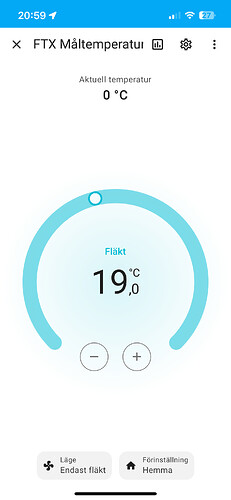

There is also a bug for us econordic users in the ventilation part. As you see in the screenshot the temperature is 0 degrees (but it is 21.5 in my house now). It is always zero so probably some sensor missing in my product. Would be nice if this value could fall back to the extract air temperature.

Fix for the Room Temperature Display Issue
One additional improvement that would greatly enhance the integration is implementing a fallback for the room temperature in the ventilation system. If [“analogInput”, 75] ‘Room temperature’ reports 0.0°C, it should automatically use [“analogInput”, 59] ‘Extract air temperature’ instead. This would ensure that room temperature is always displayed correctly, even for systems without a dedicated room sensor.

HA entities that do not work on EcoNordic WH4 (and why)
  • FTX Room temperature always reads 0.0°C on WH4. The unit does not expose a true indoor temperature sensor. A practical alternative is using extract air temperature as a proxy.
  • Runtime/status entities for timed functions does not map 1:1, since WH4 uses trigger objects plus separate timer values (2029 / 2036) and ventilation mode status (361).
  • On EcoNordic WH4, all ventilation modes expose explicit writable fan flow setpoints via BACnet, but these are not currently usable with the Nordic-based Home Assistant integration.
