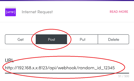

Have been spending many hours with the system in the last few days and learned a lot. I‘m loving it!
That’s how I use the flic hub with hass too. You don’t have to worry about setting any of the headers or password keys in the flic app since webhooks don’t require login authentication. Instead, they rely on you picking a unique random Webhook ID that can’t be guessed as that’s the only way it’s secured. Then, in the flic app, you only need to configure the webhook post URL to be something like this:
http://192.168.x.x:8123/api/webhook/random_id_12345
flic app:
None of the other settings on that page are required.
The related automation trigger config in hass looks like this:
platform: webhook
webhook_id: random_id_12345
or:
trigger
You can have multiple buttons point to the same webhook for invoking the same automation. However, different automations require different unique webhooks. If you wanted to use the various button press types (short/double/long) you would need a new automation and trigger for each one when using this method.
