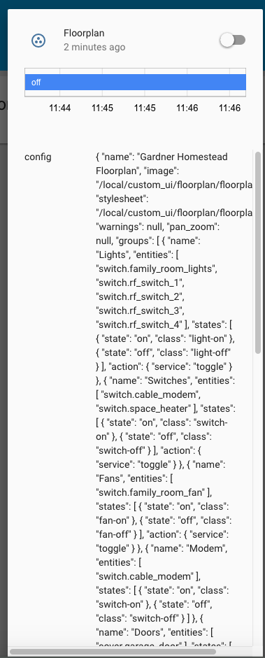

This is what I see in the frontend:

Thanks for following up on this! Unfortunately no change for me. I added the frontend.html file and made the config changes, but still appears the same. Any ideas?
Still working great as a custom panel though
In Google Chrome, it initially didn’t work for me either… until I hit Control + F5 to force a refresh. So I think clearing the cache is also a step to try… are you using Chrome?
I’m using the Mac Electron app, which I think is based on Chrome. Hitting reload a few times worked! Thanks so much!

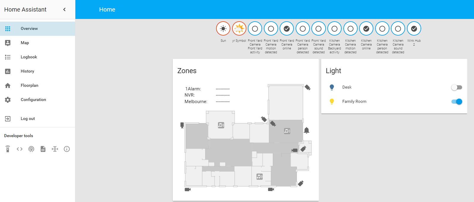

I’ve gotten the demo plan to work. It shows up in states and as a panel link on the left. How do I get the “FLOORPLAN” plan link to show up next to “Home” at the top of the screen, also couldn’t I get my “lights” card to show there too?!
Create a view in your group config, and put your groups in them. For example:
floorplan:
view: yes
- group.floorplan_group
got it to work, thx
