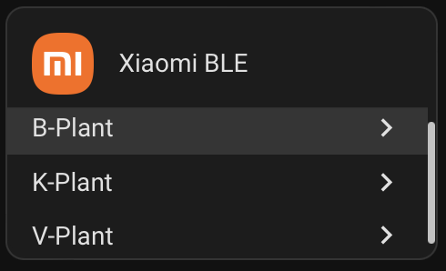

Seems good, I have added 3 devices, one started via the Flower care app and two directly to HA. They were recognized directly.

Skärmavbild 2023-01-19 kl. 21.08.55
