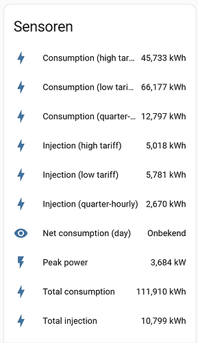

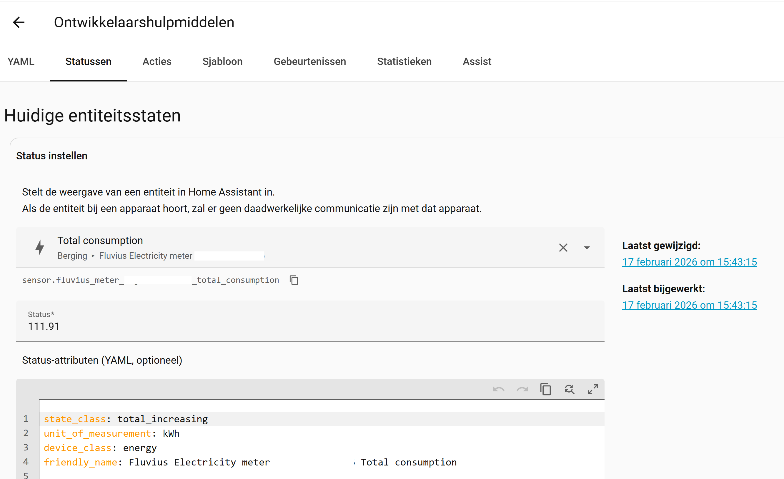

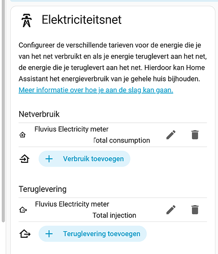

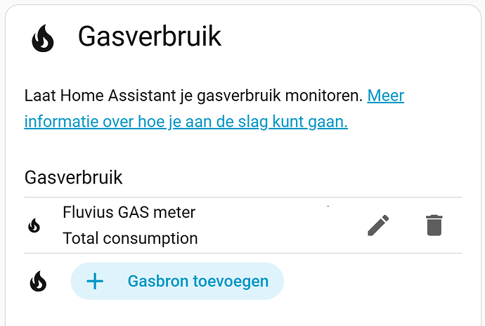

Hello, i’m new to this integration.
Installation went fluent and i was able to add both my electricity and gas meter.
I want to configue the Energy dashboard but aparently this does not seem te work. In the readme i found that i need to add the “Total consumption” sensor. But this does not seem to update the graph. In the dev tools i also don’t see any refreshes of the sensor.

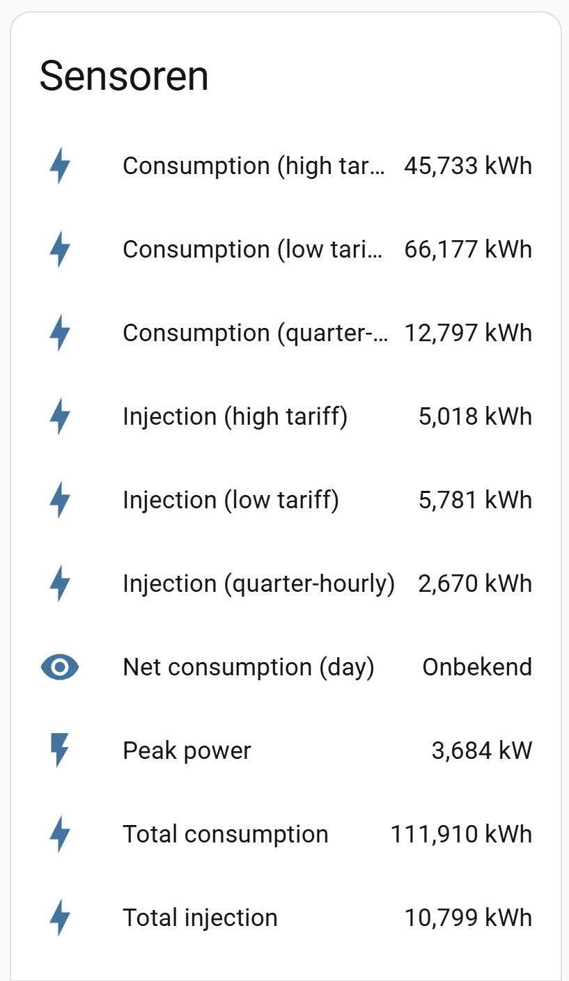

The sensors for electricity and gas seem to be working:

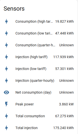

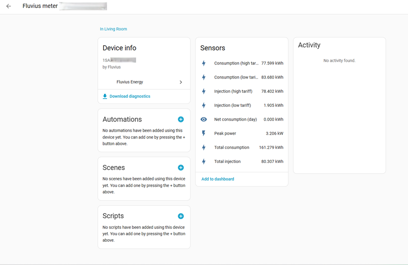

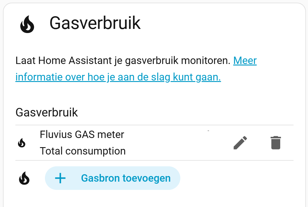

I seem to be stuck at the same spot. I can see that some meter readings have come in:

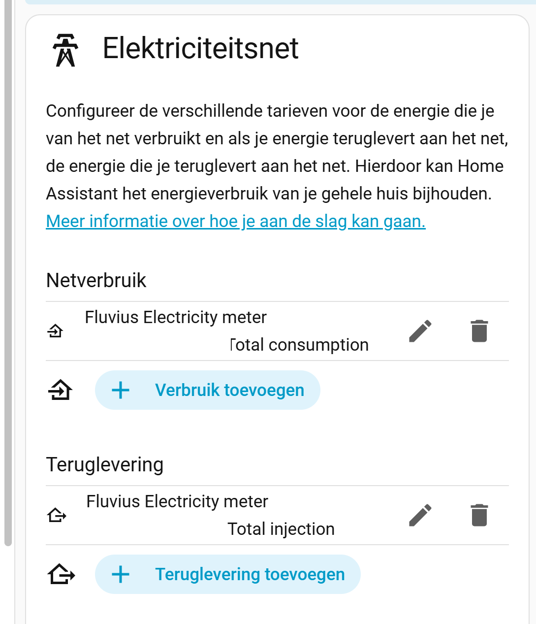

However, adding "Total consumption" and "Total injection" to the energy dashboard shows no data and the data also does not seem to be updated.
I know that energieID.be CAN automatically pull data from fluvius so it's frustrating to see that it's not so simple to get the same data into home assistant.
Note: this is the first integration I've tried on Home assistant, I'm very inexperienced. I may have missed something obvious?
