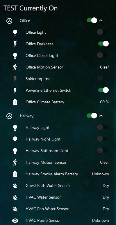

Trying to do something pretty simple but having a hard time. It’s really a use of fold-entity-row and auto-entities. I’m simply trying to show all of my rooms/groups fold-able but only display switches/lights that are on.
None of these attempts seem to work… would appreciate any hints. It seems logical to break down foldable rooms and only show entities of a specific state. TIA!
card:
  show_header_toggle: false
  title: TEST Currently On
  type: entities
filter:
  exclude:
    - state: 'off'
  include:
    - domain: group
      options:
        open: true
        type: 'custom:fold-entity-row'
      state: 'on'
show_empty: false
type: 'custom:auto-entities'
Another failure:
type: entities
title: Test
entities:
  - type: 'custom:fold-entity-row'
    head: group.office
    open: true
    head: group.hallway
    open: true
How don’t they work?
