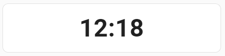

Hi all,
I’m struggling with something that I suspect is really simple. I’m still very new to HA, so please excuse my ignorance and and forum faux pas, first time poster.
I’m trying to set up a simple clock. I’ve done the sensor.time bit and that’s fine.
I’ve set the icon to mdi:void to get rid of the little clock icon as I only want the time.
I’d like it to be a larger font and centralized, but I’m struggling. At the moment, on the card I have the following:
type: entities
entities:
  - entity: sensor.time
    icon: void
    secondary_info: none
    card_mod:
      style: |
        ha-card {
          --card-primary-font-size: 50px
state_color: false
show_header_toggle: false
I believe I’ve got card_mod installed and an available resource
But I can’t get the clock to display any bigger. Any ideas?

Amazing! This got me where I needed to be, thank you!

Thanks for your response! I’ll bear this in mind for other things I’m doing :+1:
For anybody looking for the finished thing, here is it.
type: custom:mushroom-entity-card
entity: sensor.time
icon_type: none
style: |
  ha-card {
    align-items: center;
    --secondary-text-color: white;
    --card-secondary-font-size: 103px
