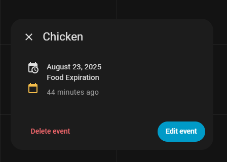

Now all my wife has to do as she unloads groceries is to say “hey (wake word) - (food item) expires on (whatever date she reads off the food item.)” I don’t need a fancy speaker for this, as all it responds with is “done.” This creates a single-day entry in the “Food Expiration” calendar and she can look at the week and plan out what she wants to make for breakfast/lunch/dinner.
