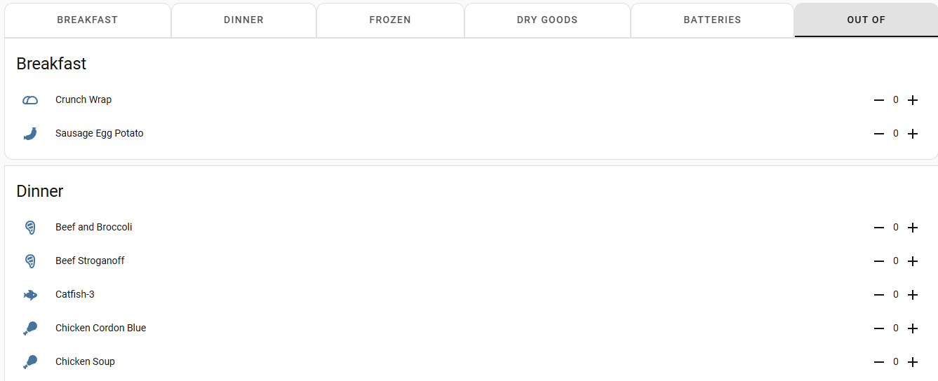

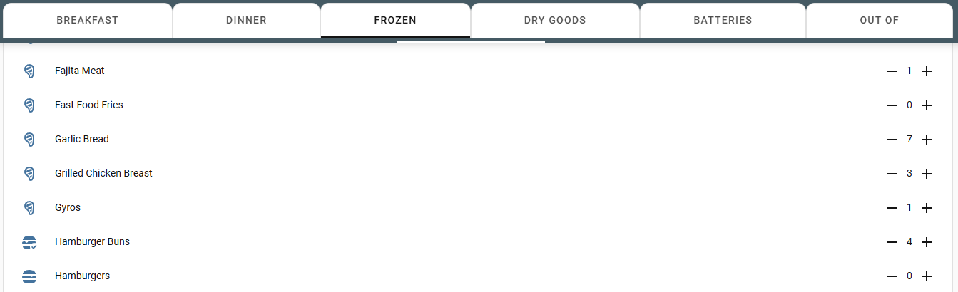

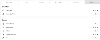

And, finally, the dashboard has two views. Screenshots below.
  • The first view uses auto-entities, decluttering-card, card-templater, and numberbox-card to select all of the fridge input_numbers. This allows us to select all of the foods in one view, separate them by type, and fill in both the fridge and the freezer numberbox-cards for each item.
  • The second view uses auto-entities and numberbox-card. Here we only select the fridge input_numbers that are greater than zero. We then show only what is in the fridge freezer and is already upstairs.
Dashboard

views:
  - title: Frozen Food
    path: frozen-food
    icon: mdi:food-steak
    badges: []
    cards:
      - type: vertical-stack
        cards:
          - type: markdown
            content: |
              ## Breakfast
          - type: custom:auto-entities
            card:
              type: entities
            card_parm: cards
            filter:
              include:
                - entity_id: input_number.fridge_breakfast*
                  options:
                    type: custom:decluttering-card
                    template: frozen_foods
                    variables:
                      - entity: this.entity_id
            sort:
              method: name
          - type: markdown
            content: |
              ## Dinner
            card:
              type: entities
            card_parm: cards
            filter:
              include:
                - entity_id: input_number.fridge_dinner*
                  options:
                    variables:

I want to do something like you did. Where are you at today with this? How has it evolved?
Well, we bought a new house and the freezer is now upstairs in the laundry room. So I no longer have freezer and fridge items like when I was moving items from the basement to the upstairs freezer.
I have added more categories. I now have frozen, breakfast, dinner, dry goods, and batteries (with all of the battery powered HA devices).
I split up my input_number file by those categories. They are in a directory under homeassistant called input_number. So, the line in my configuration.yaml to load them is:
input_number: !include_dir_merge_named input_number/
The breakfast and dinner categories are for foods I have prepared, vacuum bagged, and froze. The frozen category is for foods that come from the store frozen. Dry goods are cases of toilet paper, kleenex, etc that are stored in the basement.
My dashboard is now tabbed for the categories along with the last tab listing what we are out of.
It uses card_mod to keep the tabs at the top of the screen when scrolling down.
Summary
type: custom:mod-card
card_mod:
  style:
    tabbed-card $: |
      mwc-tab-bar {
        position: sticky;
        top: 56px; /*var(--header-height); */
        display: block;
        z-index: 999;
      mwc-tab {
        background: var(--ha-card-background, var(--card-background-color, white) );
        border-color: var(--ha-card-border-color, var(--divider-color, #e0e0e0) );
        border-width: 1px;
        border-top-left-radius: 12px;
        border-top-right-radius: 12px;
        border-style: solid;
        overflow: hidden;
      section article > * {
        --ha-card-border-radius: 0px 0px 12px 12px;
card:
  type: custom:tabbed-card
  tabs:
    - attributes:
        label: Breakfast
      card:
        card:
          type: entities
        card_parm: cards
        filter:
          include:
            - entity_id: input_number.freezer_breakfast*
              options:
                type: custom:numberbox-card
        sort:
          method: name
    - attributes:
        label: Dinner
      card:
        card:
          type: entities
        card_parm: cards
        filter:
          include:
            - entity_id: input_number.freezer_dinner*
              options:
        sort:
          method: name
    - attributes:
        label: Frozen
      card:
        card:
          type: entities
        card_parm: cards
        filter:
          include:
            - entity_id: input_number.freezer_frozen*
              options:
        sort:
          method: name
    - attributes:
        label: Dry Goods
      card:
        card:
          type: entities
        card_parm: cards
        filter:
          include:
            - entity_id: input_number.freezer_dry*
              options:
        sort:
          method: name
    - attributes:
        label: Batteries
      card:
        card:
          type: entities
        card_parm: cards
        filter:
          include:
            - entity_id: input_number.battery*
              options:
        sort:
          method: name
    - attributes:
        label: Out Of
      card:
        cards:
            show_empty: false
            card:
              type: entities
              title: Breakfast
            card_parm: cards
            filter:
              include:
                  state: "= 0"
                  options:
            sort:
              method: name
            show_empty: false
            card:
              type: entities
              title: Dinner
            card_parm: cards
            filter:
              include:
                  state: "= 0"
                  options:
            sort:
              method: name
            show_empty: false
            card:
              type: entities
              title: Frozen Foods
            card_parm: cards
            filter:
              include:
                  state: "= 0"
                  options:
            sort:
              method: name
            show_empty: false
            card:
              type: entities
              title: Dry Goods
            card_parm: cards
            filter:
              include:
                  state: "= 0"
                  options:
            sort:
              method: name
            show_empty: false
            card:
              type: entities
              title: Batteries
            card_parm: cards
            filter:
              include:
                  state: "= 0"
                  options:
            sort:
              method: name
I created a todo list called bring_upstairs. The wife can add items to it to let me know to bring up whatever dry goods she needs. We have tablets all over the house with the same dashboard. The one down in my office uses a different user id. The dashboard has a card at the top that only shows when it is the office tablet id and the todo list has new items on it.
