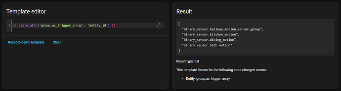

This works as expected as I go into the develeper tools I get this result:
Now I want to build a script that repeats a specific action for each of these entities listed in the group. I’ve followed this existing community article but I get an error saying:
