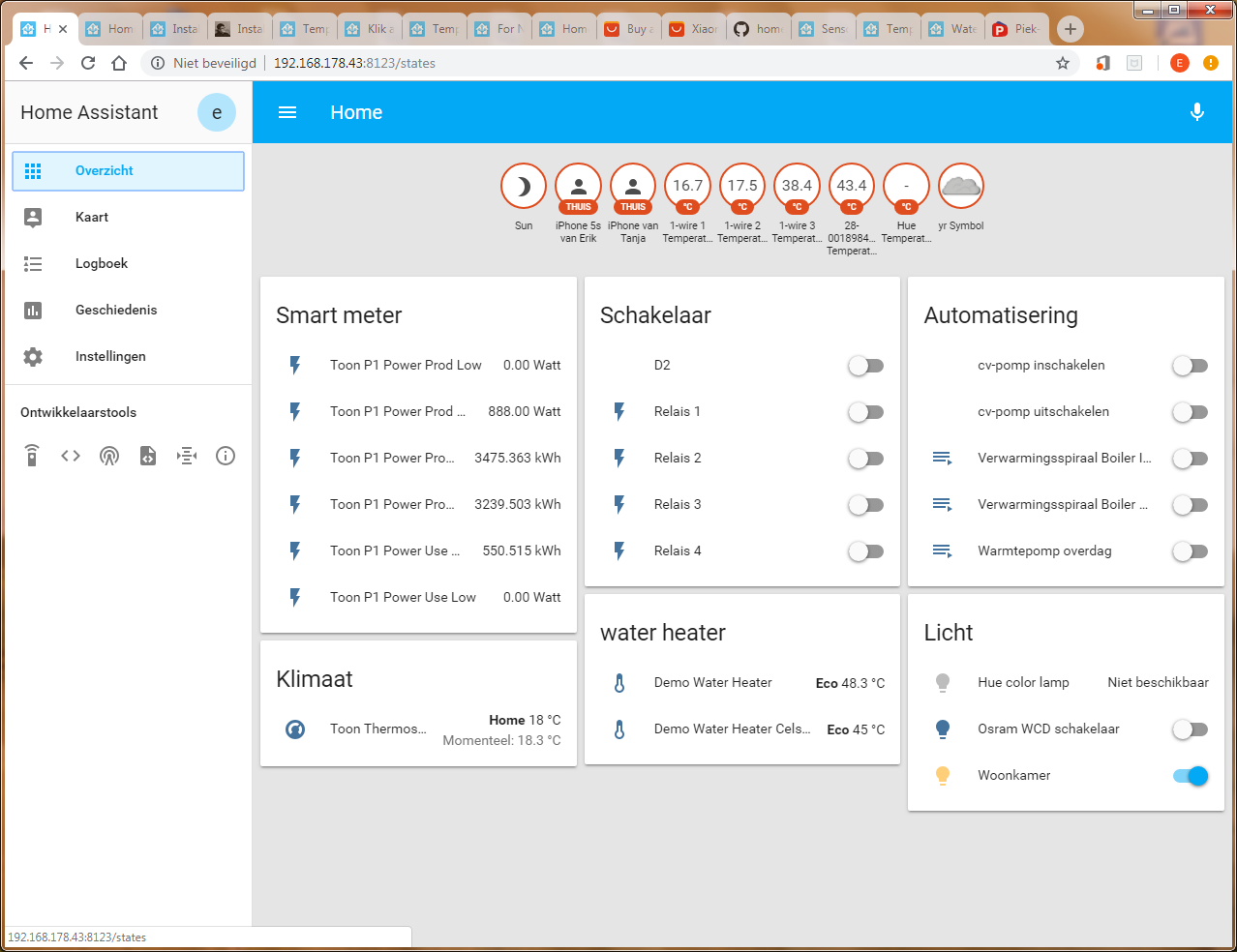

Put that one right on the bottom of my configuration.yalm
Oh, ok. A made sensor is a .yalm file. That helps a lot already
This is how it looks over here right now

I also have a Toon and hoog/laag tarief. So I created a new template sensor that actual decides based on the meter output:
