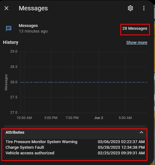

how to reset Messages entity? Everytime there’s warning or notification to fordpass app. messages will increase but I just want to reset it to zero . how can I do.
thank u.
