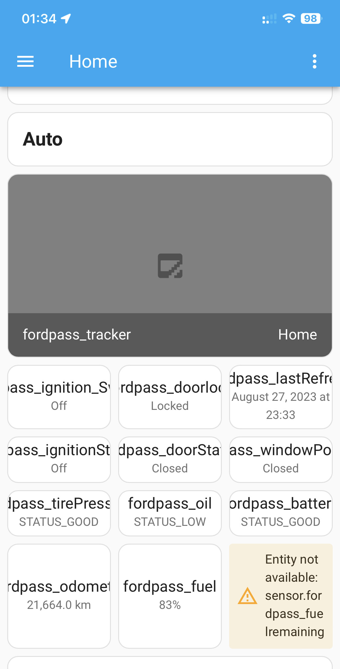

Hi All, i have fordpass avalible in South Africa but i see there is not a region option for South Africa, also in SA you register your fordpass account with a mobile number and not a email address, anyone know of a workaround for these two challenges ? Thanks G
Yes, be careful with update schedules (yours seem very reasonable). I have previously used the FordPass integration with homebridge, and its initial setting caused frequent polling, in turn causing Ford to block my account access to their servers (apparently hosted on *.ibmcloud.com). With a friendly intervention from FordPass support personnel my account was unlocked again, but I’ve since stopped using it with homebridge. Trying again now with Home Assistant, and your great guidance in this forum is truly appreciated!
Great instructions Obi, thanks for that contribution. Would you mind sharing the pictures (or a mock-up) that you use for the device tracker, namely the DeppBlue and the DeppBlue_away files, to give us an indication of what it would look like on a card? I would like to enhance my instance because right now it does not look very appealing as you can gather from the attached screenshot.
Ssure, of course.
here u are:
I think I screenshotted the Ford configurator back in the days to get my exact car…
KR Kai

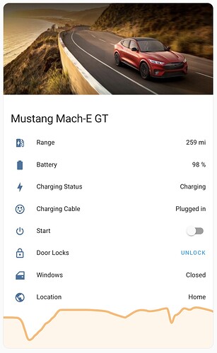

in the mean time, i made this nice card for the front end.
type: entities
entities:
  - entity: sensor.fordpass_elveh
    secondary_info: none
  - type: attribute
    attribute: Battery Fill Level
    icon: mdi:battery
    suffix: '%'
  - entity: sensor.fordpass_elveh_plug_charging_status
    icon: mdi:lightning-bolt
  - entity: sensor.fordpass_elveh_plug_state
    icon: mdi:ev-plug-type1
  - entity: switch.fordpass_ignition_switch
  - entity: lock.fordpass_doorlock
    icon: mdi:lock-outline
  - entity: sensor.fordpass_windowposition
    icon: mdi:car-door
  - entity: device_tracker.fordpass_tracker
header:
  type: picture
  image: >-
    https://pictures.dealer.com/l/levittownfordfd/1545/ecf2d68c9eac42e902cfdc51fb31b11ex.jpg?impolicy=downsize_bkpt&w=412
footer:
  type: graph
  graph: line
  hours_to_show: 24
  unit: '%'
  detail: 2
title: Mustang Mach-E GT
I made two template sensors to format the data in the attributes of sensor.fordpass_elveh
    fordpass_elveh_plug_state:
      friendly_name: 'Charging Cable'
      value_template: >
        {% if state_attr('sensor.fordpass_elveh', 'Plug Status') == 1 %}
        Plugged in
        {% elif state_attr('sensor.fordpass_elveh', 'Plug Status') == 0 %}
        NOT Plugged in
        {% else %}
        error
        {% endif %}
    fordpass_elveh_plug_charging_status:
      friendly_name: 'Charging Status'
      value_template: >
        {% if state_attr('sensor.fordpass_elveh', 'Charging Status') == 'ChargingAC' %}
        Charging
        {% elif state_attr('sensor.fordpass_elveh', 'Charging Status') == 'ChargeTargetReached' %}
        Charging Complete
        {% else %}
        NOT Charging
        {% endif %}

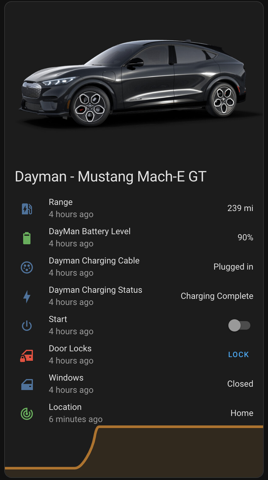

Here’s my card and code. I started it as a Vertical Stack in case I wanted to add a different card below, but haven’t added more yet. Also, I modified the following:
  • Used the template sensor for battery level I had previously configured
  • adjusted the door lock icon to the default
  • enabled color for sensor state
  • added secondary info for when the sensor was last updated
  • added conditional rows when charging to show several items such as how much energy is being transferred from the sensor on the EVSE, the Zwave switch to toggle EVSE on/off, the time until vehicle reaches 90%, and energy required to get to 90%. → I couldn’t figure out how to merge these into a more concise conditional statement, so ended up with what you can see below.
  • Used the image available on ford.com when I log in to my fordpass account, and I found that adjusting the number at the end from 1-5 changes the orientation of the vehicle.
  • added a tap action for the vehicle image to take me to the device integration page for this vehicle within HA for more information.
type: vertical-stack
cards:
  - type: entities
    entities:
        secondary_info: last-updated
      - entity: sensor.fordpass_battery_level
      - entity: sensor.fordpass_charging_cable
      - entity: sensor.fordpass_charging_status
      - type: conditional
        conditions:
            state: Charging
        row:
          entity: sensor.direct_wire_indoor_outdoor_smart_switch_electric_production_w
      - type: conditional
        conditions:
            state: Charging
        row:
          entity: switch.direct_wire_indoor_outdoor_smart_switch
      - type: conditional
        conditions:
            state: Charging
        row:
          entity: sensor.fordpass_time_to_charge_battery_to_90
      - type: conditional
        conditions:
            state: Charging
        row:
          entity: sensor.fordpass_energy_to_90
        icon: mdi:car-door
    header:
      type: picture
      image: >-
        https://www.digitalservices.ford.com/fs/api/v2/vehicles/image/full?vin=REDACTED&year=2022&countryCode=USA&angle=1
      tap_action:
        action: navigate
        navigation_path: /config/devices/device/fa2868b9f882b1845ca13ea5e95dc1cd
    footer:
      type: graph
      hours_to_show: 24
      detail: 2
    title: Dayman - Mustang Mach-E GT
    state_color: true
And if you’re interested, here are the template sensors I used to calculate the charge time and energy to 90%.
# Fordpass Energy to 90%
- sensor:
  - name: "Fordpass Energy to 90%"
    unique_id: "fordpass_energy_to_90"
    unit_of_measurement: "kWh"
    device_class: "energy"
    state: >
      {% set percent = states('sensor.fordpass_battery_level') | float(0) / 100.0 | float(0) %}
      {% set energy = 91 | float(0) %}
      {% set charge = ((0.9 - percent) * energy) | float(0) %}
      {{ charge }}
# Forpass Time to Charge Battery to 90%
- sensor:
  - name: "Fordpass Time to Charge Battery to 90%"
    unique_id: "fordpass_time_to_charge_battery_to_90"
    state: >
      {% set a = states('sensor.fordpass_energy_to_90') | float(0.0001) %}
      {% set b = states('sensor.direct_wire_indoor_outdoor_smart_switch_electric_production_w') | float(0.0001) %}
      {% if b > 5 %}
        {% set decimal_hours = a / b * 1000 %}
      {% else %}
        {% set decimal_hours = 0.0 %}
      {% endif %}
      {% set minutes = (decimal_hours % 1 * 60) | round(0) %}
      {% set decimal_hours = decimal_hours| int(0) %}
      {% if minutes  <= 9 %}
        {% set min = '0' ~ minutes | string %}
      {% else %}
        {% set min = minutes | string %}
      {% endif %}
      {{ decimal_hours ~ ':' ~ min }}
