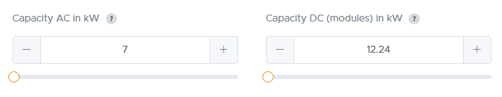

My first PV install consisted of 7110 Wp of PV with an 7 kVA inverter. Last year, I added panels to my installation to go with 12000+ Wp but keeping the same inverter.
It would be nice if we could specify the size the inverter on top of how much the panels can produce on peak time, a bit like what SolCast is doing.
