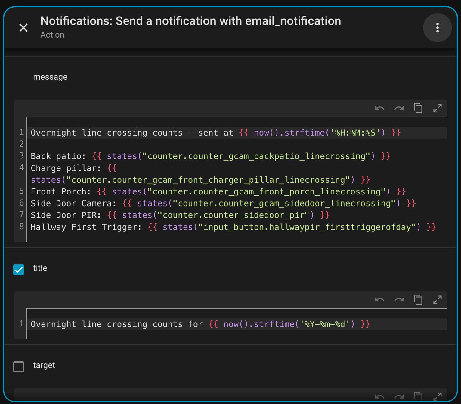

I have an email notification automation which sends the timestamp of the last time a helper button has been pressed (input_button.hallwaypir_firsttriggerofday) which works fine but the format is not very readable.
Using below code in notification ‘message field’ body within the automation:
Hallway First Trigger: {{ states("input_button.hallwaypir_firsttriggerofday") }}

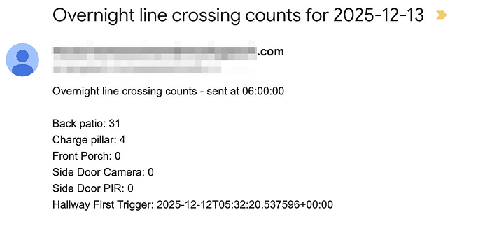

it comes out like this in email:
Hallway First Trigger: 2025-12-12T05:32:20.537596+00:00
Ideally I’d like it to display in dd/mm/yy hh:mm:ss format
Any ideas? I’ve tried a range of versions from various posts but it seems to fail (syntax errror) or come back with ‘unknown’ in the email body instead.

Notifcation email Message body:
Overnight line crossing counts - sent at {{ now().strftime('%H:%M:%S') }}
Back patio: {{ states("counter.counter_gcam_backpatio_linecrossing") }}
Charge pillar: {{ states("counter.counter_gcam_front_charger_pillar_linecrossing") }}
Front Porch: {{ states("counter.counter_gcam_front_porch_linecrossing") }}
Side Door Camera: {{ states("counter.counter_gcam_sidedoor_linecrossing") }}
Side Door PIR: {{ states("counter.counter_sidedoor_pir") }}
{{ as_local(as_datetime(state_attr('sinput_button.hallwaypir_firsttriggerofday', 'datetime_23'))).strftime('%-I %p') }}
Error given:
Error rendering data template: ValueError: Template error: as_datetime got invalid input 'None' when rendering template 'Overnight line crossing counts - sent at {{ now().strftime('%H:%M:%S') }} Back patio: {{ states("counter.counter_gcam_backpatio_linecrossing") }} Charge pillar: {{ states("counter.counter_gcam_front_charger_pillar_linecrossing") }} Front Porch: {{ states("counter.counter_gcam_front_porch_linecrossing") }} Side Door Camera: {{ states("counter.counter_gcam_sidedoor_linecrossing") }} Side Door PIR: {{ states("counter.counter_sidedoor_pir") }} Hallway First Trigger: {{ states("input_button.hallwaypir_firsttriggerofday") }} {{ as_local(as_datetime(state_attr('sinput_button.hallwaypir_firsttriggerofday', 'datetime_23'))).strftime('%-I %p') }}' but no default was specified
