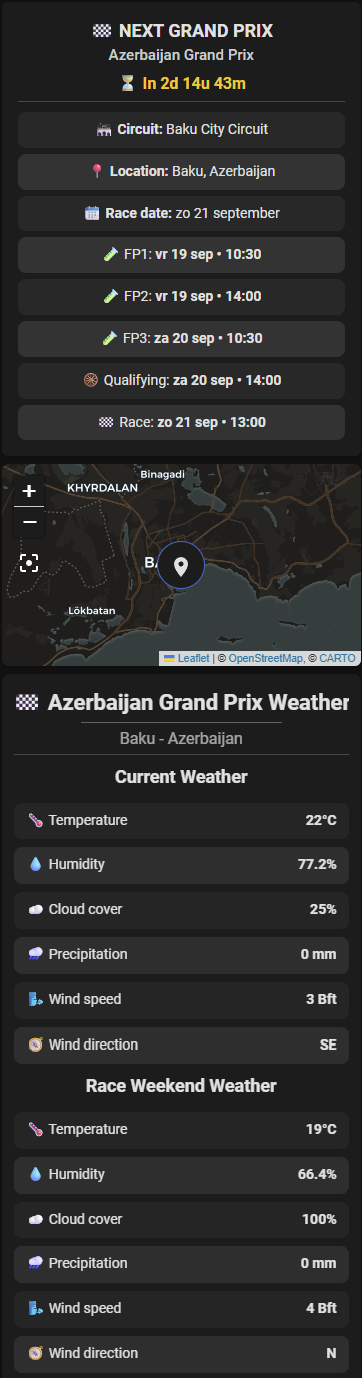

  1. Next Grand Prix — shows the upcoming race with session schedule, countdown timer, circuit map and live weather for both current conditions and race time forecast

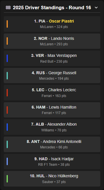

  3. Driver Standings — top 10 with team colors and points bar, expandable to all 22 drivers

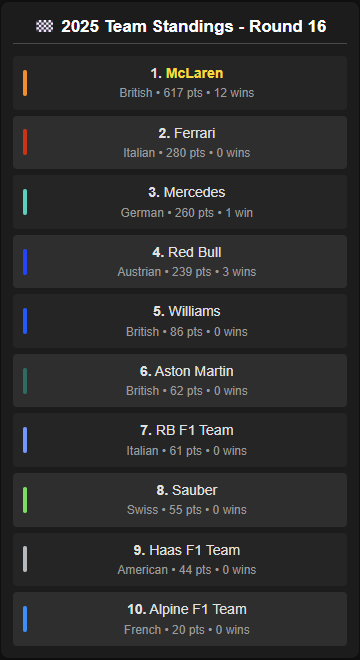

  4. Constructor Standings — same style as driver standings, expandable to all 11 teams

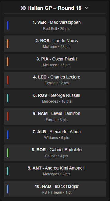

  5. Last Race Results — full results with team colors, points, DNF status and expandable to all 22 drivers

1. Next Grand Prix
Shows the upcoming race with a session schedule, countdown timer, circuit map and live weather forecast for both current conditions and race time. Sessions that are live are highlighted in yellow. Past sessions are greyed out. The card automatically adapts when a sprint race weekend is detected, sprint sessions only appear when scheduled.

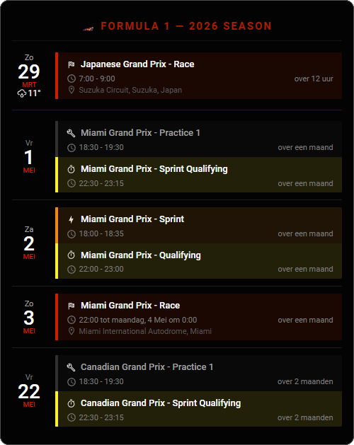

    color: "#FFFFFF"
    accent_color: "#FF8C00"
    label: mdi:lightning-bolt
    show_location: false
  - entity: calendar.f1_season_calendar
    allowlist: Sprint Qualifying$
    color: "#FFFFFF"
    accent_color: "#FFA500"
    label: mdi:timer-sand
    allowlist: Practice
    color: "#AAAAAA"
    accent_color: "#444444"
    label: mdi:wrench-outline
start_date: today
days_to_show: 275
compact_events_to_show: 5
compact_events_complete_days: true
filter_duplicates: true
language: nl
title: 🏎️ Formula 1 — 2026 Season
title_font_size: 22px
title_color: "#E10600"
background_color: var(--ha-card-background, var(--card-background-color,
vertical_line_width: 4px
event_spacing: 6px
additional_card_spacing: 8px
max_height: 650px
day_separator_width: 1px
day_separator_color: "#333333"
month_separator_width: 1px
month_separator_color: "#E1060060"
today_indicator: pulse
today_indicator_color: "#E10600"
weekday_font_size: 11px
weekday_color: "#888888"
day_font_size: 28px
day_color: "#FFFFFF"
month_font_size: 10px
month_color: "#E10600"
weekend_weekday_color: "#AAAAAA"
weekend_day_color: "#FFFFFF"
today_weekday_color: "#E10600"
today_day_color: "#E10600"
today_month_color: "#E10600"
event_background_opacity: 12
show_countdown: true
show_progress_bar: true
progress_bar_color: "#E10600"
event_font_size: 13px
event_color: "#FFFFFF"
time_24h: true
time_font_size: 11px
time_color: "#888888"
remove_location_country: true
location_font_size: 11px
location_color: "#666666"
weather:
  position: date
  date:
    show_conditions: true
    show_high_temp: true
    show_low_temp: false
    icon_size: 14px
    font_size: 12px
    color: var(--primary-text-color)
  event:
    show_temp: true
    icon_size: 14px
    font_size: 12px
  entity: weather.buienradar
tap_action:
  action: expand
refresh_interval: 60
type: custom:calendar-card-pro
card_mod:
  style: |
    ha-card {
      background: var(--ha-card-background, var(--card-background-color, #1e1e1e)) !important;
      border: 0px solid rgba(225,6,0,0.19) !important;
      border-radius: 12px !important;
      box-shadow: 0px 4px 24px rgba(225,6,0,0.12) !important;
      overflow: hidden;
    ha-card .header-container h1.card-header {
      font-size: 15px !important;
      font-weight: bold !important;
      letter-spacing: 2px !important;
      text-transform: uppercase !important;
      text-align: center !important;
      float: none !important;
      border-bottom: 1px solid rgba(225,6,0,0.25) !important;
      padding-bottom: 8px !important;

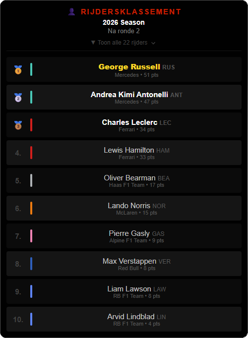

3. Driver Standings
Shows the current driver standings with team colours, driver name and points. Displays the top 10 by default. Tap the card to expand and show all 22 drivers.
Required boolean
input_boolean:
  f1_drivers_toggle:
    name: Show all drivers
    initial: false
type: custom:button-card
entity: sensor.f1_driver_standings
show_name: false
show_state: false
show_icon: false
layout: custom
tap_action:
  action: call-service
  service: input_boolean.toggle
  service_data:
    entity_id: input_boolean.f1_drivers_toggle
styles:
  grid:
    - grid-template-areas: |
        "header"
        "standings"
    - row-gap: 12px
  card:
    - padding: 12px
    - border-radius: 12px
    - background: var(--ha-card-background, var(--card-background-color,
    - color: white
    - font-family: sans-serif
    - box-shadow: 0px 4px 24px rgba(225,6,0,0.12)
    - border: 0px solid rgba(225,6,0,0.19)
  custom_fields:
    header:
      - padding-bottom: 6px
      - border-bottom: 1px solid rgba(225,6,0,0.25)
    standings:
      - display: flex
      - flex-direction: column
      - gap: 6px
custom_fields:
  header: |
      if (!entity?.attributes) return "Geen data";
      const expanded = states['input_boolean.f1_drivers_toggle']?.state === 'on';
      const icon = expanded ? "mdi:chevron-up" : "mdi:chevron-down";
      return '<div style="width: 100%; text-align: center;">'
        + '<div style="font-size: 15px; font-weight: bold; letter-spacing: 2px; text-transform: uppercase; color: #E10600;">👤 Rijdersklassement</div>'
        + '<div style="font-size: 14px; font-weight: bold; color: #ffffff; margin-top: 4px;">' + entity.attributes.season + ' Season</div>'
        + '<div style="font-size: 13px; color: #888888; margin-top: 2px;">Na ronde ' + entity.attributes.round + '</div>'
        + '<div style="display: inline-flex; align-items: center; gap: 4px; margin-top: 6px; cursor: pointer;">'
        + '<span style="font-size: 12px; color: #555555;">' + (expanded ? '▲ Toon minder' : '▼ Toon alle ' + entity.attributes.driver_standings.length + ' rijders') + '</span>'
        + '<ha-icon icon="' + icon + '" style="--mdc-icon-size: 16px; color: #555555;"></ha-icon>'
        + '</div></div>';
  standings: |
      if (!entity?.attributes?.driver_standings) return "Geen data";
      const standings = expanded
        ? entity.attributes.driver_standings
        : entity.attributes.driver_standings.slice(0, 10);
      const teamColors = {
        "Mercedes":         "#00D2BE",
        "Ferrari":          "#E8002D",
        "McLaren":          "#FF8000",
        "Red Bull":         "#3671C6",
        "Haas F1 Team":     "#B6BABD",
        "RB F1 Team":       "#6692FF",
        "Audi":             "#B5B5B5",
        "Alpine F1 Team":   "#FF87BC",
        "Williams":         "#64C4FF",
        "Cadillac F1 Team": "#D9042B",
        "Aston Martin":     "#229971"
      return standings.map(function(d, idx) {
        const pos = d.positionText !== '-' ? parseInt(d.positionText) : (idx + 1);
        const code = d.Driver.code;
        const name = d.Driver.givenName + ' ' + d.Driver.familyName;
        const team = d.Constructors[0]?.name || '';
        const color = teamColors[team] || "#888";
        const points = d.points;
        const isTop3 = pos <= 3;
        const medal = pos == 1 ? '🥇' : pos == 2 ? '🥈' : pos == 3 ? '🥉' : pos + '.';
        const nameDisplay = pos == 1 ? '<b style="color: gold">' + name + '</b>' : name;
        const bg = idx % 2 === 0 ? 'rgba(255,255,255,0.04)' : 'rgba(255,255,255,0.08)';
        return '<div style="display: flex; align-items: center; background: ' + bg + '; padding: 6px 10px; border-radius: 4px; height: 38px;">'
          + '<div style="min-width: 28px; font-size: ' + (isTop3 ? '18px' : '15px') + '; font-weight: bold; text-align: center; color: ' + (pos == 1 ? '#FFF200' : isTop3 ? '#ffffff' : '#555555') + ';">' + medal + '</div>'
          + '<div style="width: 4px; height: 26px; background: ' + color + '; border-radius: 2px; margin: 0 10px; flex-shrink: 0;"></div>'
          + '<div style="flex: 1;">'
          + '<div style="font-size: 15px; color: ' + (isTop3 ? '#ffffff' : '#cccccc') + '; font-weight: ' + (isTop3 ? 'bold' : 'normal') + ';">' + nameDisplay + ' <span style="font-size: 12px; color: #666666;">' + code + '</span></div>'
          + '<div style="font-size: 11px; color: #666666;">' + team + ' • ' + points + ' pt' + (points == 1 ? '' : 's') + '</div>'
          + '</div></div>';
      }).join('');

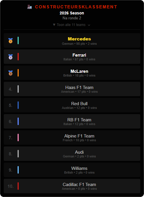

Shows the current constructor standings with team colours and points. Displays the top 10 by default. Tap the card to expand and show all 11 teams.
Required boolean
input_boolean:
  f1_race_toggle:
    name: Show all teams
    initial: false
entity: sensor.f1_constructor_standings
show_name: false
show_state: false
show_icon: false
layout: custom
tap_action:
  service_data:
    entity_id: input_boolean.f1_race_toggle
styles:
  grid:
        "header"
        "standings"
    - row-gap: 12px
  card:
    - padding: 12px
    - color: white
  custom_fields:
    header:
    standings:
      - display: flex
      - gap: 6px
custom_fields:
  header: |
      const expanded = states['input_boolean.f1_race_toggle']?.state === 'on';
        + '<div style="font-size: 15px; font-weight: bold; letter-spacing: 2px; text-transform: uppercase; color: #E10600;">🏭 Constructeursklassement</div>'
        + '<span style="font-size: 12px; color: #555555;">' + (expanded ? '▲ Toon minder' : '▼ Toon alle ' + entity.attributes.constructor_standings.length + ' teams') + '</span>'
        + '</div></div>';
  standings: |
      if (!entity?.attributes?.constructor_standings) return "Geen data";
        ? entity.attributes.constructor_standings
        : entity.attributes.constructor_standings.slice(0, 10);
        "Audi":             "#B5B5B5",
      return standings.map(function(c, idx) {
        const pos = c.positionText !== '-' ? parseInt(c.positionText) : (idx + 1);
        const name = c.Constructor.name;
        const nationality = c.Constructor.nationality;
        const points = c.points;
        const wins = c.wins;
        const color = teamColors[name] || "#888";
          + '<div style="font-size: 15px; color: ' + (isTop3 ? '#ffffff' : '#cccccc') + '; font-weight: ' + (isTop3 ? 'bold' : 'normal') + ';">' + nameDisplay + '</div>'
          + '<div style="font-size: 11px; color: #666666;">' + nationality + ' • ' + points + ' pt' + (points == 1 ? '' : 's') + ' • ' + wins + ' win' + (wins == 1 ? '' : 's') + '</div>'
          + '</div></div>';
      }).join('');

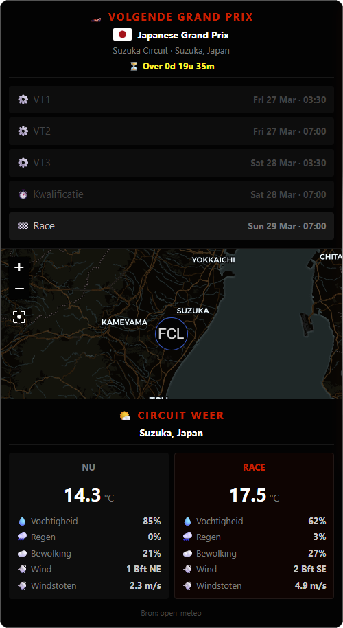

Here is the link where everything is neatly in one post.
Share: Full F1 Dashboard — 10 cards with live timing, standings, weather, calendar and more · Nicxe/f1_sensor · Discussion #445

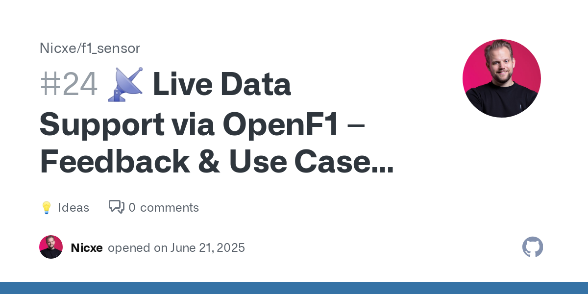

There’s been some interest in adding live Formula 1 data to this integration – such as flag status and race control messages – and I’ve decided to take a closer look at it.
I’m now working on integrating OpenF1 into the f1_sensor integration to bring real-time race data into Home Assistant. This could open up fun automation possibilities like syncing your lights with track flags, announcing safety car events, or triggering “race mode” scenes.
I’ve started a GitHub discussion to gather feedback and ideas from the community – you can join the conversation here:
Let me know what you’d love to automate during a race!

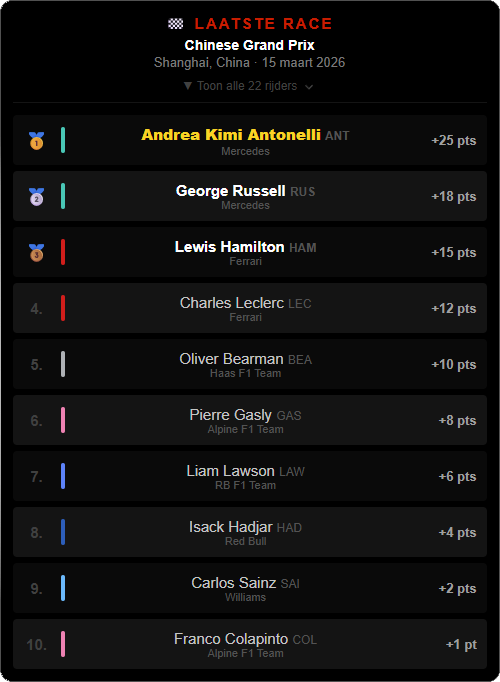

Awesome, I will look into using this in the card on Friday
Nice looking card mate, I had a quick go before with setting it up and created the Boolean.
How come you say create the f1_race_results Boolean but the one in the code is f1_drivers_toggle.
For some reason mine doesn’t show any data or do anything when I click on it.
I’ve not had chance to fully check where I’ve gone wrong.
Have you created any more cards ?
Thanks
Yes, of course, it should be input_boolean.f1_drivers_toggle, not input_boolean.f1_race_results. I mixed it up with the other maps I have. I’ll share all my other maps this weekend.
I updated my post with all the cards I have including the code
